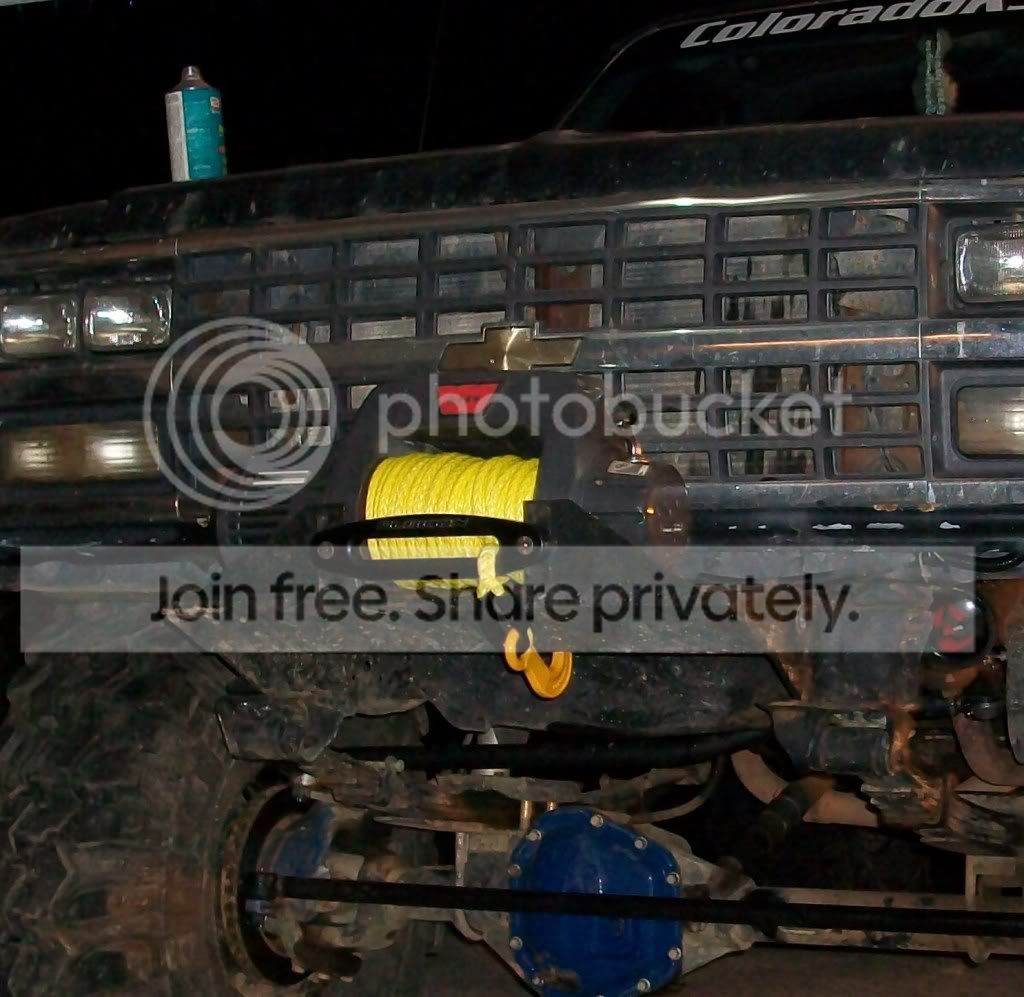

My most thoughtful and loving wife bought me some Master Pull winch line for Christmas. :D 85' of 3/8 line.
I've never ran anything but cable so I was hoping to get a thread going on this stuff.
What are the do's and don'ts, precautions, maintenance..etc.
Just searched though the pirate recovery bible, and not one mention of syntehtic rope.
There has got to be a good writeup on synthetic rope.

3/8" on a full size is what I recommend to customers. Here is some information for you.
http://www.masterpull.com/cpage.cfm?cpid=197
I think my max weight is 18k on the 3/8 line. 85' is as much as you can fit on the average winch.

I believe I run 100' of 3/8" synthetic rope on my 8274.
You can certainly use a snatch block, many will recommend you get a brand new snatch block (there isn't a special one for synthetic) but i just made sure there weren't any burrs in the one I had and used it with no problems.
The sheath is a really good idea, I've already destroyed one but the rope was undamaged, way worth it.
I really liked my rope but on a really hard pull it would pull the rope down into the layers under the top layer and would bind it up and made free spooling it out a PITA, almost had to hook it to a four wheeler or something to get it unwrapped a few times, on the steel cable I could just power the winch out when it did that but on the rope I couldnt.
If you had a problem like that then most likely it wasn't spooled on the winch tight enough. I ususally have to resool my winch a couple times a year to avoid that due to how much I use it. I hook it to a tree and drag the truck to it.

100' will fit on most winches which is what I am running.
Yes, a snatch block is safe.
The sheath is a good idea, I use mine quite a bit.
I spool my rope onto the winch at a bit of an angle (back and forth) to avoid this problem
