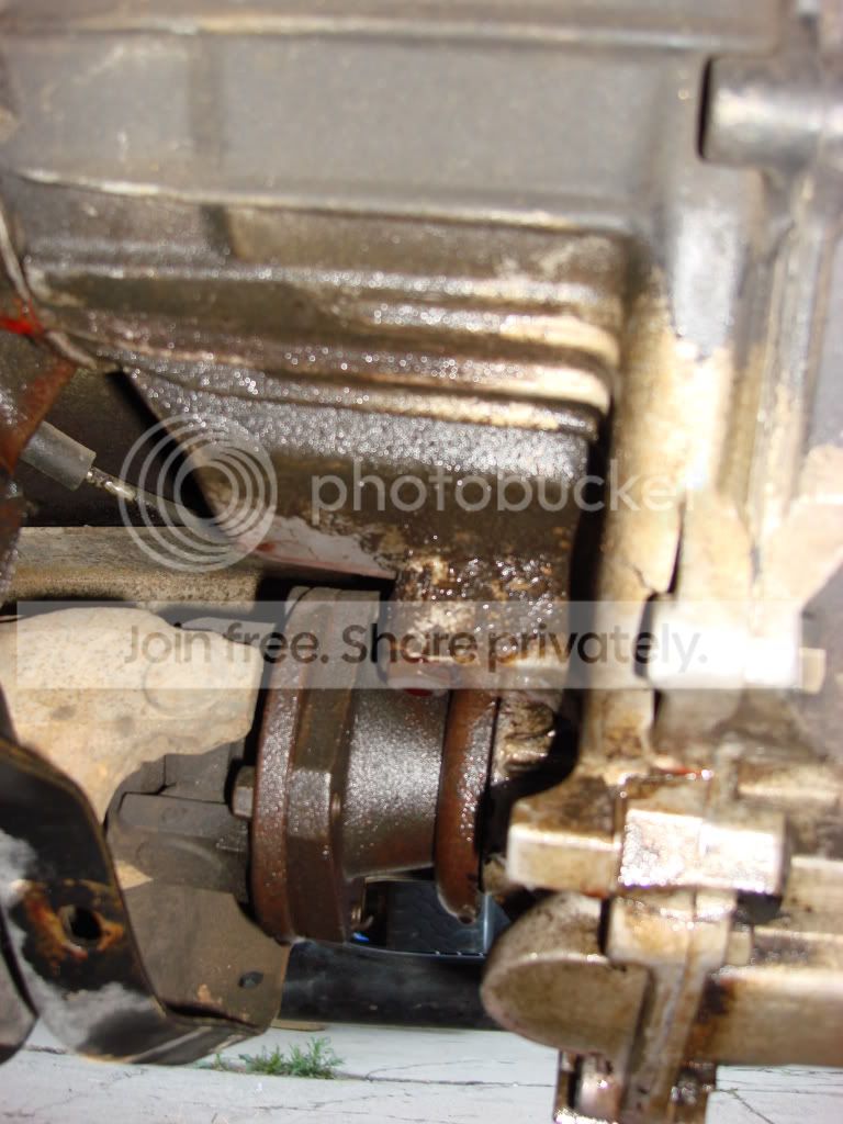

What is the name of the black splined inner seal on front output shaft and does anyone know where I can buy one its leaking bad. All the autoparts I went do dont carry it. Oh its a np241 Thanks

The autoparts didnt even know what the hell I was talking about. Its a black rubber splined plastic washer/o-ring type.
Going to guess here but are you saying that this seal is to keep oil from leaking out the splines and not from around the yoke? If so pull the yoke off and make sure that there is not a groove from the yoke seal, replace that seal while it is off and clean up the splines and yoke and threads of any oil and seal the end of the shaft at the washer and nut with RTV silicone and call it done.

Are you sure the oil is leaking past the splines and not through the front output seal?
If it is leaking past the splines, pull the yoke off, clean everything up and put some rtv on the splines.
