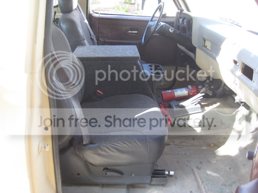

Allright, here's the pics
Just an overall view - I threw together a console out of some MDF and old carpet. Its huge, I can put A LOT of shtuff in it. I also finally have cupholders!

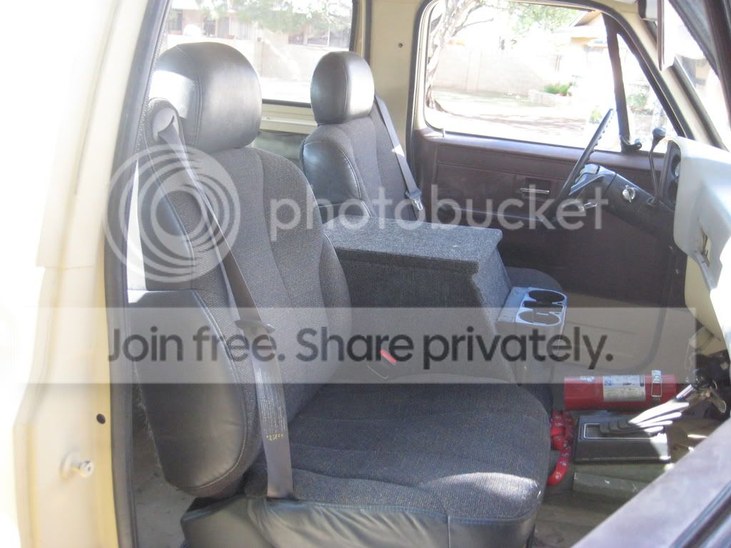

All the way back.

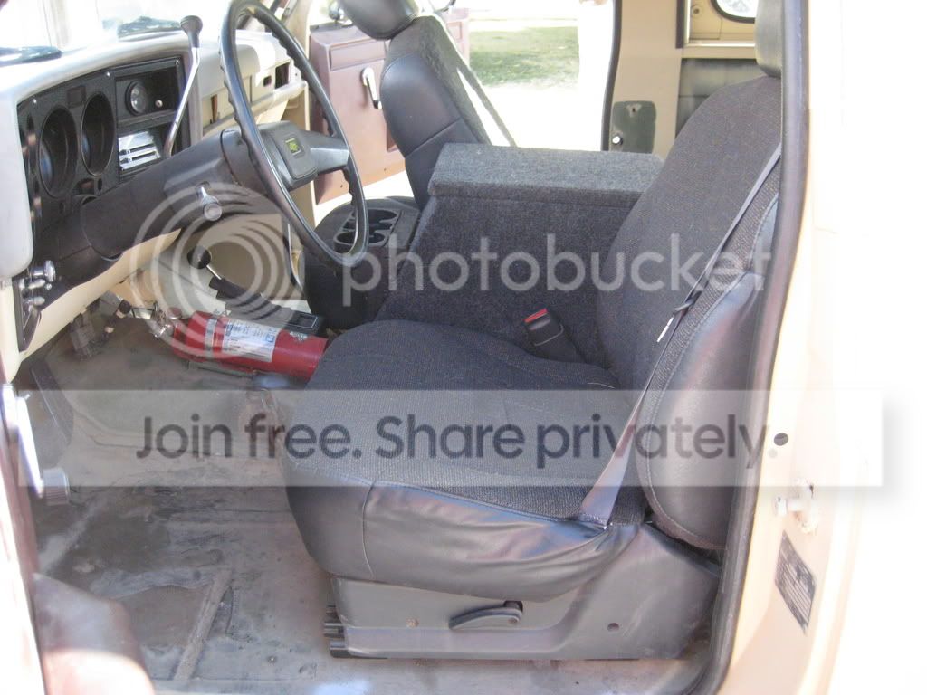

All the way forward.

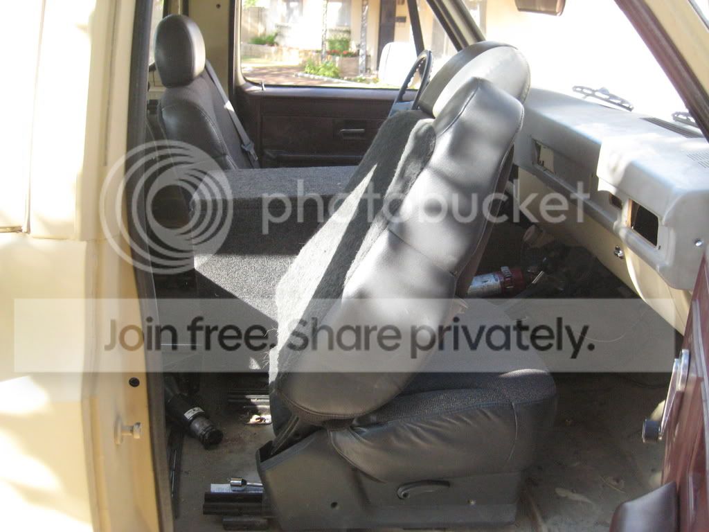

All the way tilted forward (also they recline nearly flat)

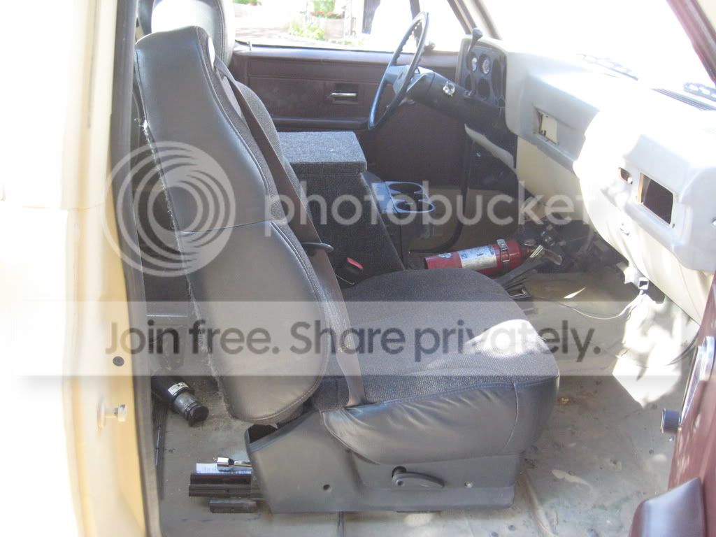

Driver's side.
I used the existing forward most hole closest to the trans tunnel, then drilled new for all the other mounts. Make sure its "square" before you drill. No one likes to sit in a crooked seat!
