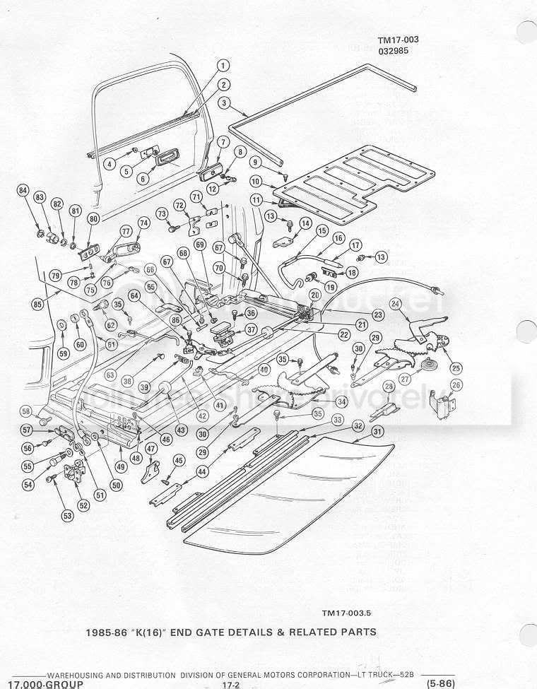

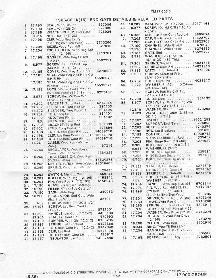

    Here is some thing that might help you!
    [​IMG]
    [​IMG]

    Hey thanks Metrodps, those exploded diagrams are always helpful. I gonna print all this stuff out.
