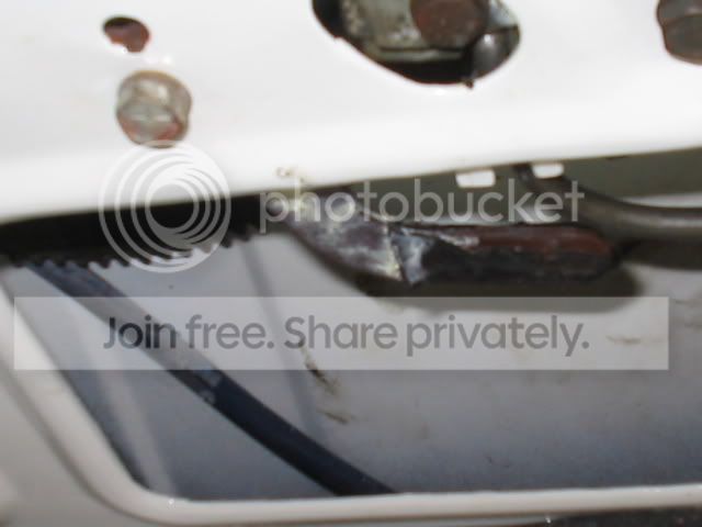

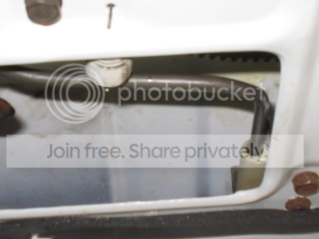

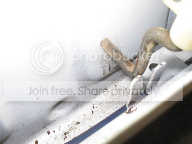

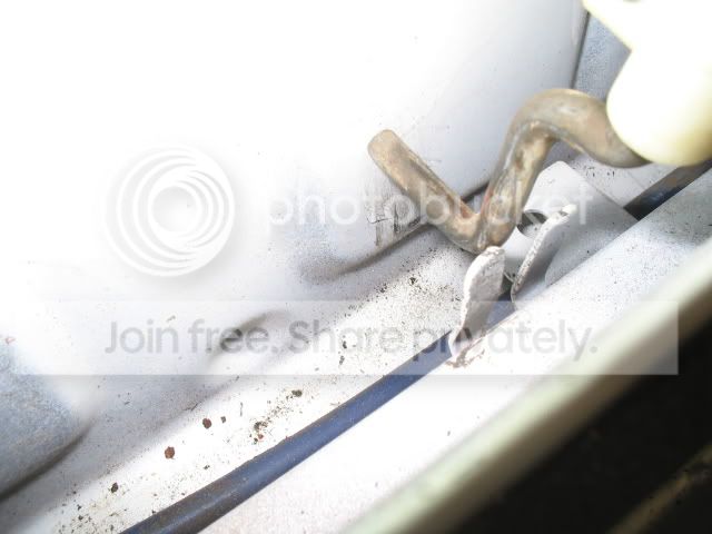

here are some pics ....
1st i bent these tabs back i hope its not a problem
the window closes fully now these were in the way
wat are these two things for?
That mechanism is a safety device that does not allow the tailgate to open unless the window is all the way down.
