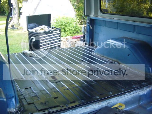

    okay boys, show me some pics of your tailpan replacements. i have a welder now, so i need to get this done.

    i replaced mine in the summer, here are some pics i dont know if they will help or not.

    that lloks good pete. is that a brand new rear floor pan also?
    where did you get it?

    Brand new NOS GM floor with tailpan and cross supports.
    GM Part #15571692
    Just searched gmpartsdirect and it does not come up anymore, hit a local dealer and have them do a search for you.

    well i called them and it has ben discontinued. guess ill have to go aftermarket
