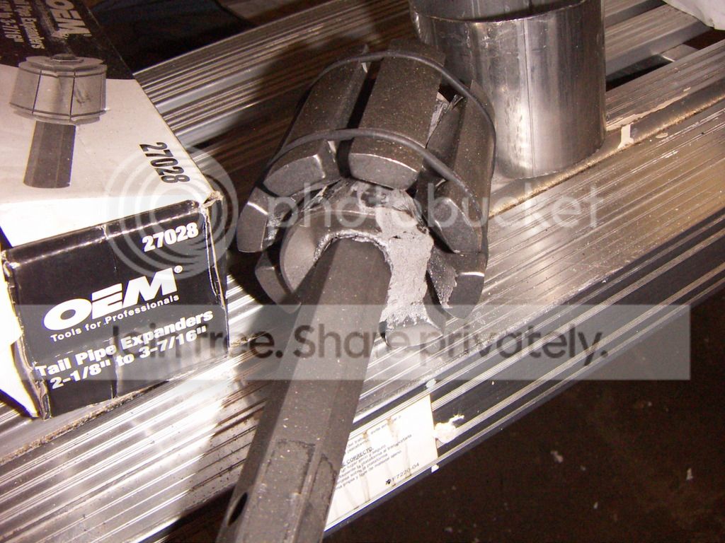

I'm trying to build an exhaust out of 3" 16 gauge 409 and having trouble expanding it. I just broke one of these:
3
Is there anything better to grab? I don't know if I can get the old exhaust back on without it crumbling.

I've used the HF version of that, which is prolly the same and is, unsurprisingly, cheap and nasty. The O-rings rotted away quickly, but I seem to recall that it'll work if I WD40 the thing, and magically hold it in place by hand. Hit it with the cordless impact and it did its job. :dunno:
-- A
I read the reviews of the HF one and everyone seems to be stripping the threads. On this one I broke one of the ramp pieces, which is some kind of porous pot metal. The threads did pretty well to stalling the impact at 110psi.
It's giving me a cone shape at the end instead of a nice flared end. I can remember using one successfully before, so I'm not sure what's different. Maybe the far end was damaged and not sliding up like it should. I might just swap for another and keep trying. I hit the threads with anti-sieze, but the ramps seemed kind of oily so I left them alone. It has definitely been used before.
These things are junk. Went through many of them little to no success.
Stainless: you will most likely even have less success. I typically light of the ol' torch and carefully put some heat into the pipe I need to expand. Stainless isn't as responsive to heat but there should be enough wiggle room.
Well that's 2 of same tool broken in one night. :doah:
Yeah, maybe butt weld is sounding good. My main reason for expanding was to get good weld penetration with no backgassing or weird gaps to fill. I don't want to buy a $280 tool to put together $80 worth of pipe. I did want one clamp connection so I can take it apart there if needed.

This is the 2nd tool I broke last night:

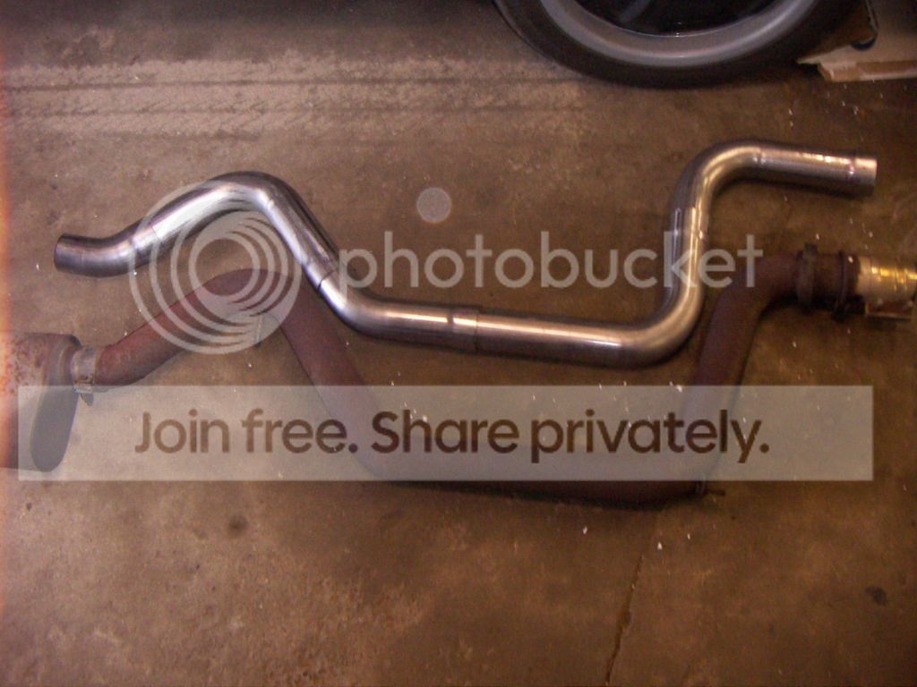

Muffler man expanded the joints for me and charged $10. I probably should have just drove the car down there with the mandrel bends and had them do the whole job. I'm sure I will still have tons of grief getting everything lined up.
I'm just copying the existing tailpipe, which is a little different routing than stock. It was obviously fabbed with a bunch of butt welds in mild steel bends.

I couldn't find any local shops that work in stainless or with mandrel bends. I found one place online offering a 3" mandrel exhaust for this car, but it was like $250 for just the tailpipe and it would be 3 pieces to put together and possibly still some custom cutting/fitting. Probably the best approach would have been to live with crush bends and aluminized and just let a shop do it. This is almost always the cheapest, easiest and fastest approach. I just wanted to keep it full 3" all the way through and have stainless.
Looking good there! Finding someone who does mandrel bent is harder them some think I drove 45 mins one way for my exhaust but for price was worth it in my area.
