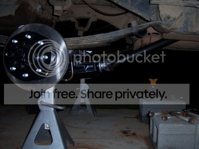

just what the title says. the blazer has a shackle flip in the rear with 2" lift springs so 6" lift. i can't get a good pic of the angle coming off the t-case b/c of the mufflers, but i used a piece of wire and bent it so it was the same as the angle coming off the t-case and got the pinion as close as i could with that as a reference...

Make ya a bet if you put longer shackles on there the pinion would go perfect...
On my truck the pinion angle was off a bit. I did 56in rear leafs, shackle flip switched around, and 8in shackles and the pinion is perfecto.
Speaking of that, I need to check mine soon. You guys know what the pinion should be set at?
on what a k5?
That looks almost the same angle as mine , And when I hit the brakes hard the u-joint trys to bind up..
BUT you have new springs AND no blocks. So yours may not do that.
But Im going to shim mine up 6* , and see if it gos away..I guess shackles are next. :dunno:
