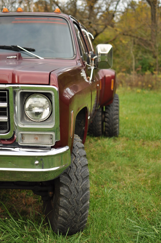

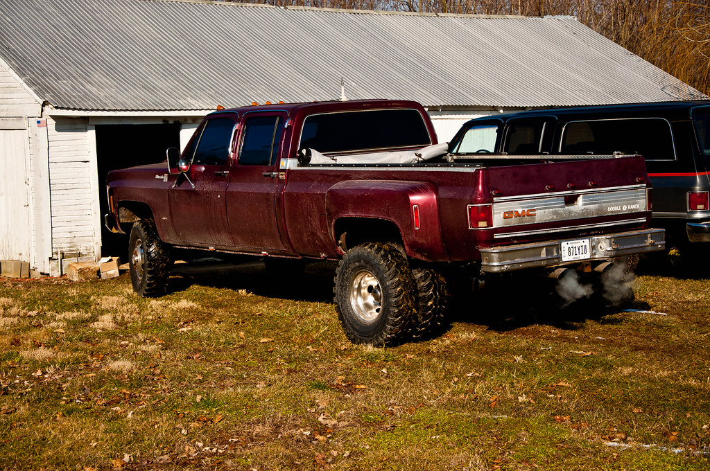

Nothing showed under my search here, so.... I have everything to do a 4" lift on my Sub. I'm kinda liking the tall skinny look, these trucks have 4" lifts with 255/85s on them. I just wish there were more options taller then a 255/85 (33x10). If anyone has some insight and maybe some pics that would be great. Thanks
