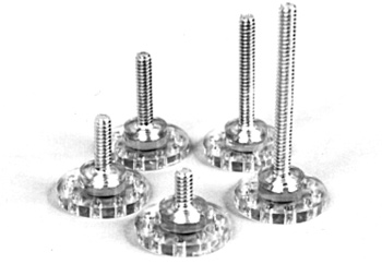

Is you connection spot hidden and is there a fair bit of room? We have these studs at work with plastic perforated mounting pads. They make good single stud junction points with ring terminals. But you gotta have room for them and its not the prettiest.
When you're done you can bundle the wires and use one of these to cover the stud:
