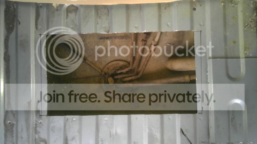

No idea if its the same as a blazer but on mine i was able to peak in from the rear wheel well and see that the lines came out of the tank right between two floor supports that run left to right. From there it was easy enough to lift the carpet up and find the spot welds for those supports from above. At that point i just cut between the two supports gauging the distance off the spot welds. You can see the floor suport spot welds in this pic of mine.
As far as how far to go left and right, thats up to you. I stopped where i did so that my patch panel would fall into the "low spots" in the floor so that when i screw it down, the screw head would possibly protrude up and create a high spot.
