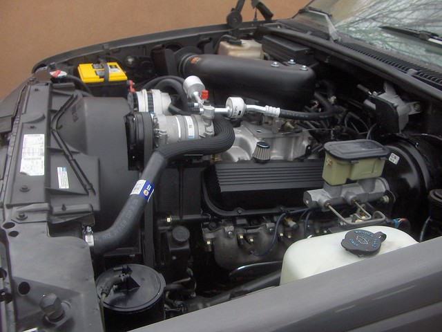

Does anybody know of a good tuner for older TBI PROMS? This past winter I swapped in a TBI 7.4L in my FIL’s 1993 C1500 Sportside. I modified the stock 4.3L harness to work with the 7.4L components and used Howell for the PROM tune. Now, I’ve had nothing but good luck with Howell on past projects but after 3 different PROM tunes I still don’t think they have this thing calibrated correctly and looking for alternatives.
The truck runs great! We’ve put about 2,000 miles on it and it has tons of smooth power through all ranges, it will smoke the tires like mad but the problem is it likes to die when coming to a stop. It does not drop a SES light nor leave codes. I’ve swapped in known good IAC motors and just about everything else. Fuel pressure is spot on at 12 psi. I am convinced they have it programmed as an automatic rather than a manual transmission. I am confident there is not a sensor issue, air leak or anything else with this engine. It has to be an outright calibration issue. They did add a “hot tune” that I would like to get rid of as my FIL is complaining about the rich smell at idle as well.

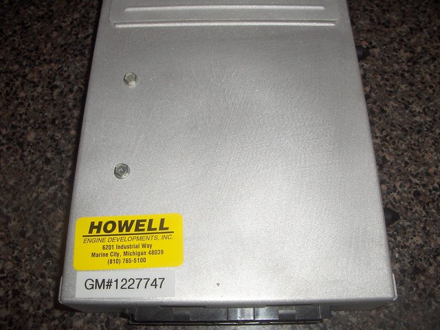

I am running a 1227747 ECM. I have an extra PROM but need a stock tune for a 1993 7.4L with a manual trans and 3:08 gears. Looking for a good alternative to Howell. Anybody got any suggestions? This truck is just a city cruiser driven by a 70 year old man, not a hot rod.

Well, a friend turned me on to Harris Performance (tbichips.com) and I called them week before last and explained what the truck was, which ECM I am using and what is it in the truck now (including the L29 Vortec cylinder heads). The PROM showed up in the mail last Friday which I toss in on Saturday. I could tell the minute I fired it up after installing the new PROM it was running much better. Even the cold open loop idle was smoother with a lower RPM idle speed (before it would idle at 1500 RPM when cold). I’ve got about 200 miles on it now since installing the new Harris Performance chip last Saturday and the dying problem is gone! :waytogo: In fact, it just all around runs better. The acceleration is smoother, the up and down of the RPM range is smoother when shifting, no more bucking when shifting, etc. The excessive "rich" smell is gone too! The truck finally runs like a healthy big block with a little truck body bolted around it now.
I am not by any means slamming Howell Engine Development, as I have had nothing but good luck with them on previous EFI swap projects and will be using them again on the 8.1L swap into the Suburban. Not sure why they couldn’t seem to get a properly tuned PROM for this truck done right in 3 attempts though so I had no choice but to try someone else. Maybe their 7.4L edit tables are corrupt or something :dunno:

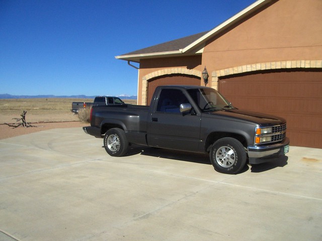

End of story….the powertrain in the little 2wd Sportside 454SS clone is done! I wouldn’t go as far to say this truck is FAST in the new world of fine running sequential port injected LS engines, but by 1993 standards this little truck hauls ass. It would probably give an 80's TPI Camaro a run for its money though :laugh:

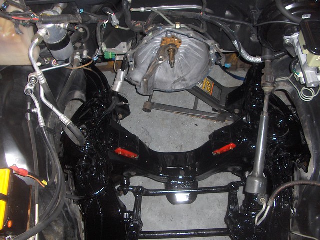

My only regret with this project is using the Energy Suspension engine mount inserts. Those mounts are a bit too stiff for a truck like this where you can really feel the engine. I used those same mounts on my K10 with the 8.1L where it feels smooth as silk at idle and throughout the RPM range. Not sure if the firing order between the 7.4L and 8.1L are that noticeable with harmonics or what the heck. GM did change the firing order on the 8.1L for the sake of smoother operation. Maybe that little bit of difference makes a big difference when it comes to using polyurethane mounts :dunno:

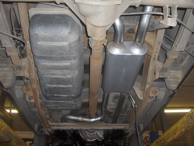

Is that a flowmaster 70 series?
Not sure…maybe? It is called the Big Block Series muffler. Flowmaster part number 527504. It sounds great, without the typical Flowmaster drone. Very mellow but yet has a nasty growl to it when you poke it in the neck. I wouldn’t mind putting one of these on the Polar Bear once it gets big blocked.
The box it came in....
Sweet! Thanks! I have a flowmaster 50 series on my burb right now and it sounds really good but is still a touch loud. Im thinking a 70 series might get it where i want.
This big block muffler is one of the best sounding Flowmasters I've ever heard. The only downside is it is HUGE and EXPENSIVE! Over 22" long and like $200.
