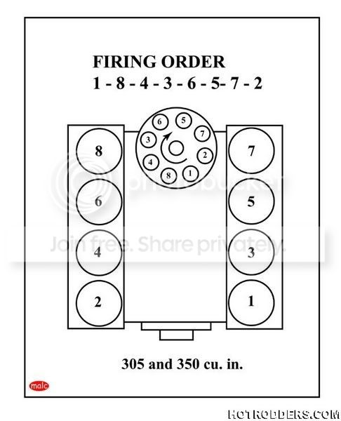

I think 4X4 high was asking how you id the cylinders because if the cyl were next to each other you may simply have a blown headgasket and an easy fix. Looking at the pic below, which cyl were low?
Cylinders 4 and 6 are the culprits then. Head gasket? No hard starts, good oil and coolant. 180,000 miles I think I'm committed to a rebuild. Love those Edelbrock headers. And I love all the ideas. Thanks guys. I'm getting excited!:laugh:
Yep, British Slave got it right, i was asking because two adjacent cylinders with low compression means a blown head gasket and a cheap easy fix (if you do the work yourself). My original engine went 240K before i built a new one so if money is tight at the moment i would do a head gasket and keep running the current engine as you plan a future engine build.
That is a tempting way to go.... Head gasket would explain bad compression and fouled plugs/miss at idle. Do you think it would cause my nasty pinging as well?
