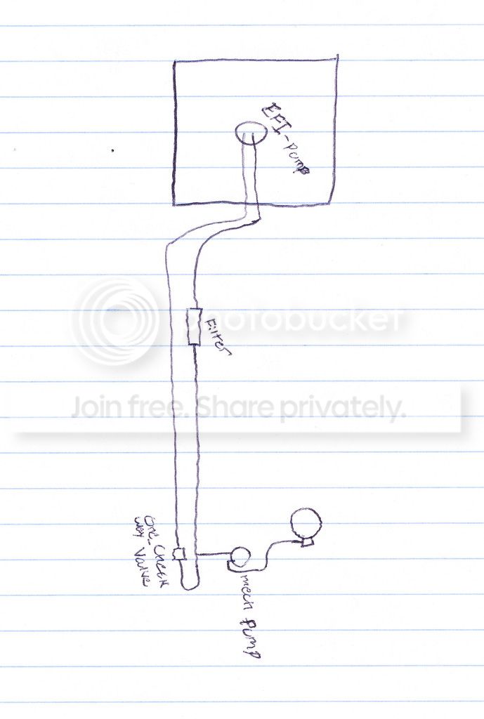

I don't know as I'd run both an electric and mechanical pump. Might be possible, but also might create unintended consequences.

it actually has a 4 speed manual in it, and all the emissions stuff was cut out by the previous owner so that will make it a bit easier. Also after doing a lot of research on this I've come to find most of the people that run both a mechanical and electric pump usually use a low PSI electric for priming and preventing vapor lock, so I came up with this idea that I sketched out, I figure I can run it this way and when the electric pump dies I'll just pull the pump and put a hose in its place. As for wiring I have a bunch of those open barrel crimps that you can find on the OEM wiring harness's that GM uses that I can use to make a clean wire setup. Also I checked yesterday, I removed the block off plate and sure enough there everything for a mechanical pump there.
