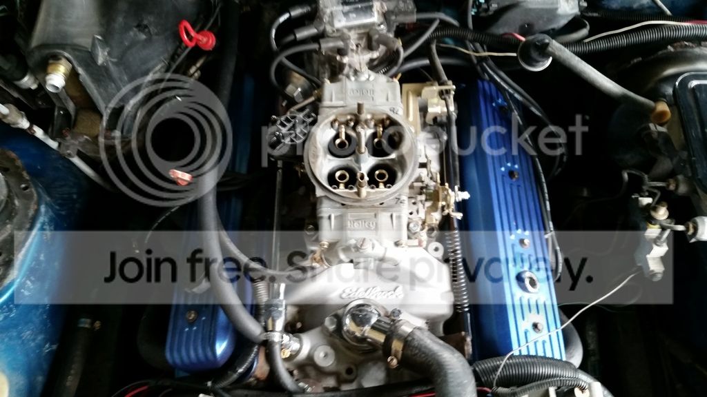

I swapped my camaro from tbi to carb which involved buying (cam,fuel pump, carb style tank pickup,non computer controlled hei dist, intake manifold, carb, throttle linkages, tv cable linkages, and probably 200$ in odds and ends.)
the reason i switched was because i added a large cam and headers and wanted to be able to tune it myself.
