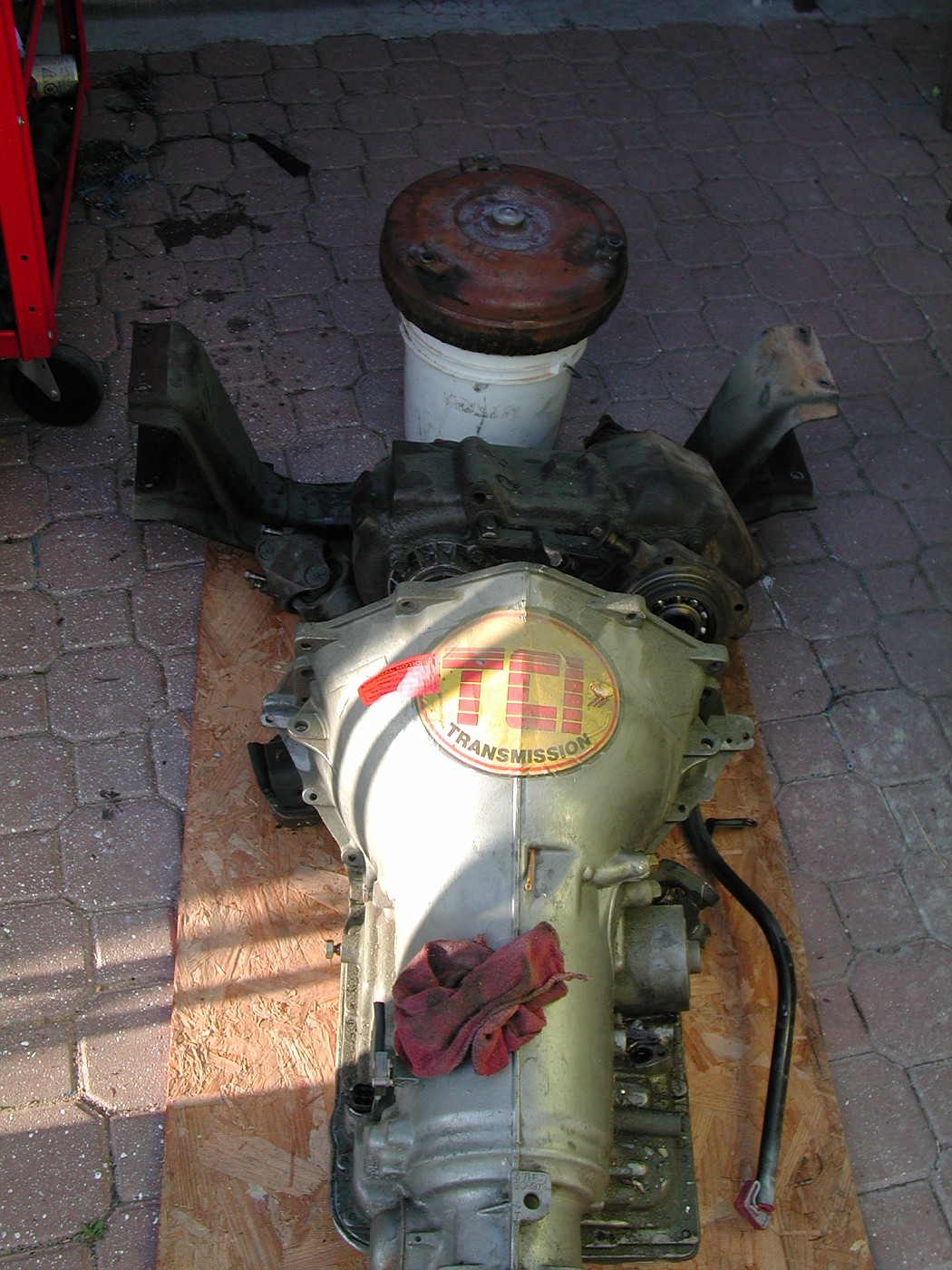

I bought mine 4 years back.No problems yet.I thought I had lost the 3-4 clutch pack once but it turned out to be the govner gear,it stripped.
I had the truck parked for 7 months while I rebuilt it and the speedo gear in the T/C rusted.When I got the truck on the road it took about 100 miles untill the rusted speedo drive gear ate away at the plastic govner gear.
What I'm saying here is that that failure was not TCI's fault.It cost $12.00 for a new gear and I was back on the road.
