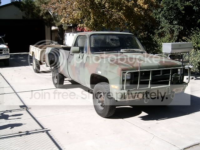

I don't agree, my conversion turned into a complete expedition trail rig restore but the 6bt even with the ve will give me the power and reliability I want and the fun factor should be way high on the scale.

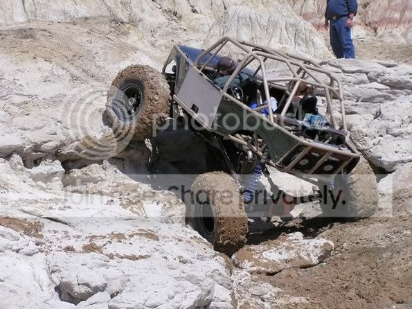

My next project will keep the 6.2 stock when I turn this
Into this:eek1:
