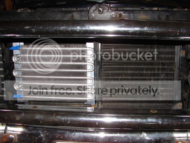

My TH350 transmission recently started slipping. I pulled the tranny for a rebuild. I installed a transmission cooler today. I am making new cooler lines. I have searched and read lots of posts but the information is conflicting. I need to know what is the return line on a TH350. Is it the top fitting on the transmission or the bottom one?
