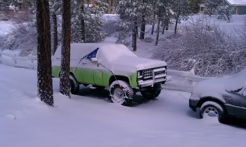

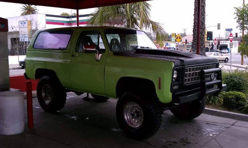

I've tried searching... but nothing came up so I'm creating a post to get a quick answer. OK so I got my trans rebuilt late last year and recently when its cold (first start of the day) and I put it into gear, whether it be REVERSE or Drive it slips like I'm driving a manual. I took it back to him and he said it needed some adjustments, so I drove it home and the next morning I started it and still the same thing... Its been there for a couple of days and he says it needs one more day. I'm just curious if you guys might know wtf is going on with it?? Side notes, it only does it really bad when first engaging and slowly goes away once it starts warming up. I also feel its really sluggish once warmed up. IDK... that just might be me thinking its sluggish lol. As for the truck its a 350ci/ TH350 on 37's with 4:10 ratios. Any input on this would be greatly appreciated.
Thanks,
Brett
and just for the heck of it a few pics of it :)
