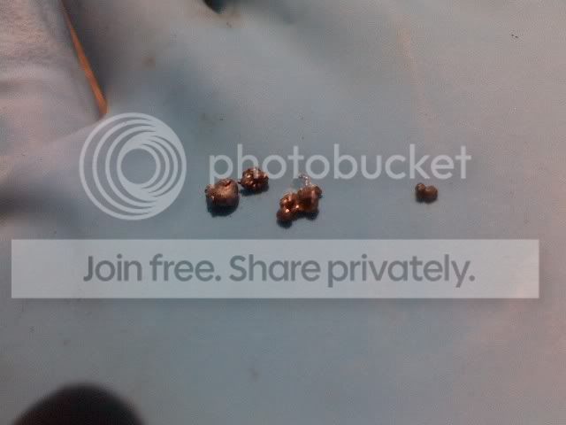

This first picture is of the bigger peices of metal I found in the bottom of the pan, other then this I saw alot of little tiny metal shavings. Is this normal wear or should I be a little more concerned? The picture probably enhances how big the peices really are, so keep that in mind. What are they from?

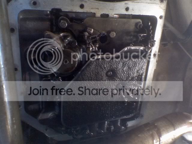

This second picture is of the whole underside of the tranny showing the filter, my questions are, do I need to check anything or tighten any of the bolts I see in here? Is this a factory filter?

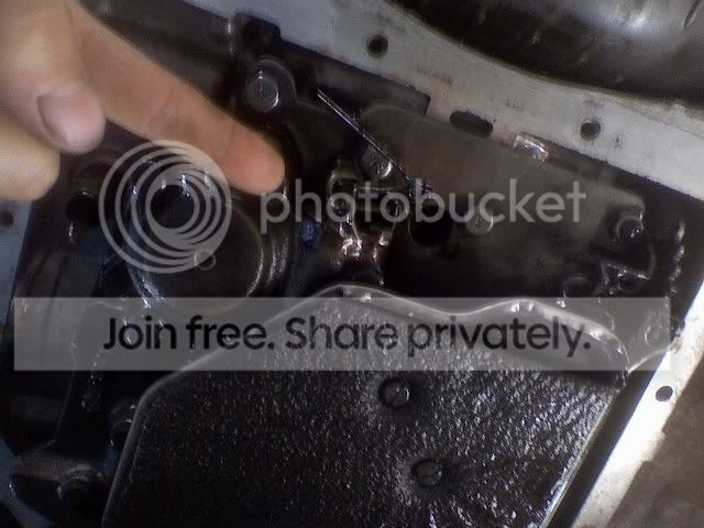

Here is something I noticed that wiggled somewhat freely, what is it and should it be moving?
Anything that you feel I shoiuld check/maintenance/tighten Id really like to hear about it so please add your 2 cents..
