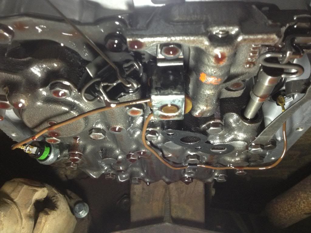

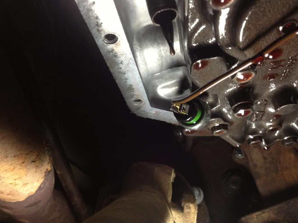

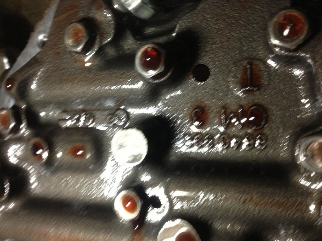

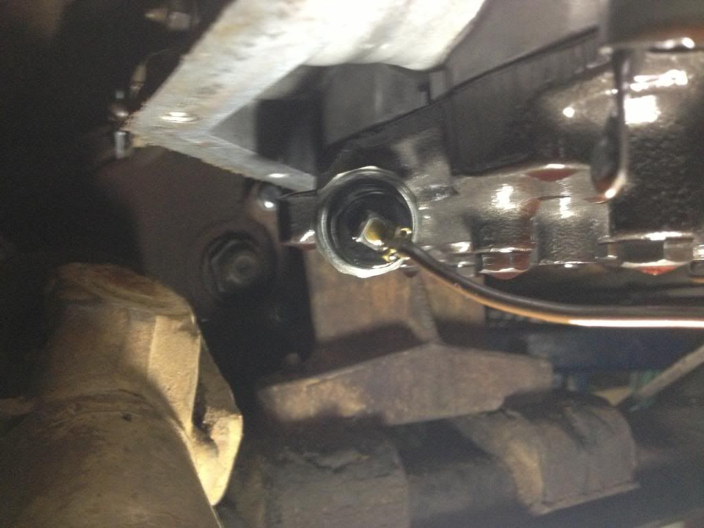

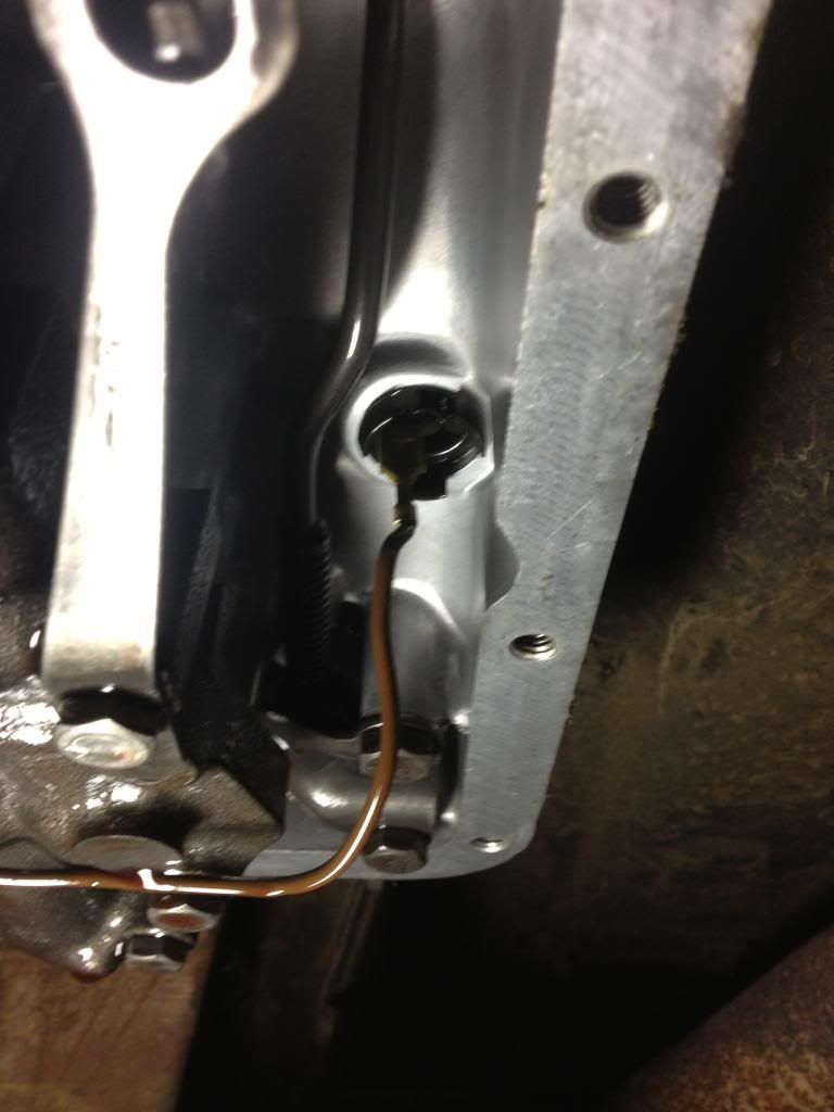

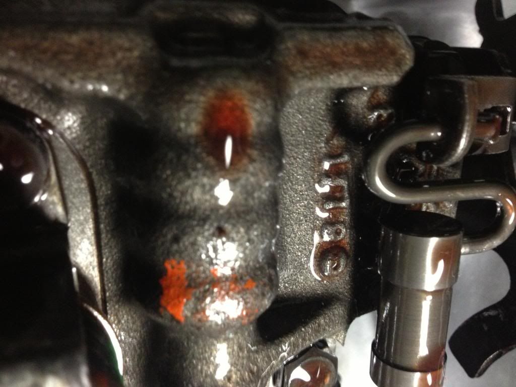

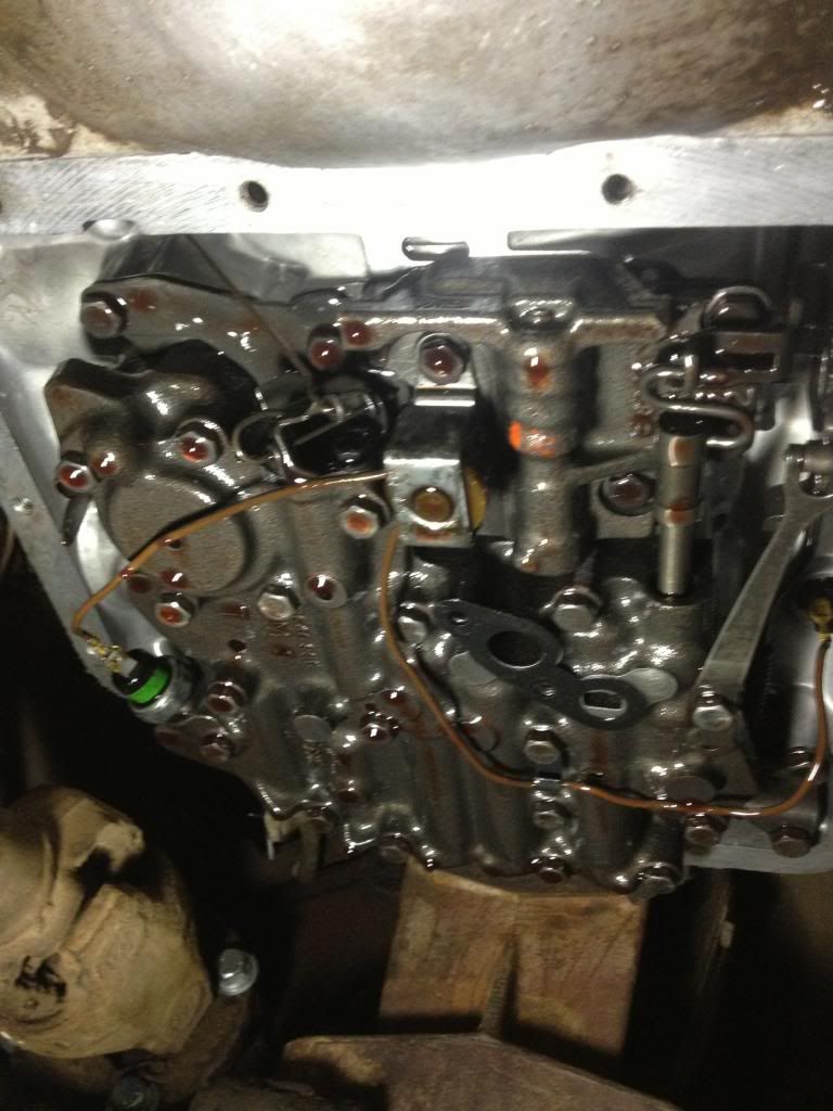

You mean the best way to use the 350 Lockup trans with lockup functioning in a non stock application?
If you can pull the pan and post or email me a picture of the internal harness/valve body (remove the filter please) I can give you the correct info to make this all work quite easily.
Super easy, just run 12 volts to the case connector, the solenoid grounds through the governor switch that is on the valve body, you can delay the speed it locks up at by changing to a higher numeric governor switch.
