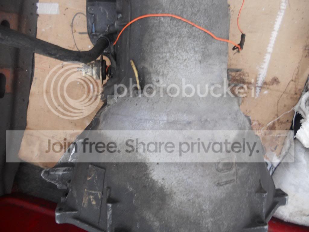

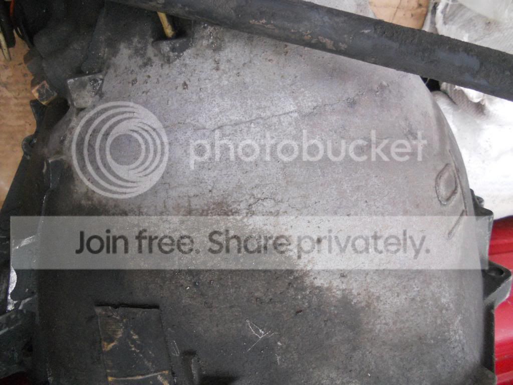

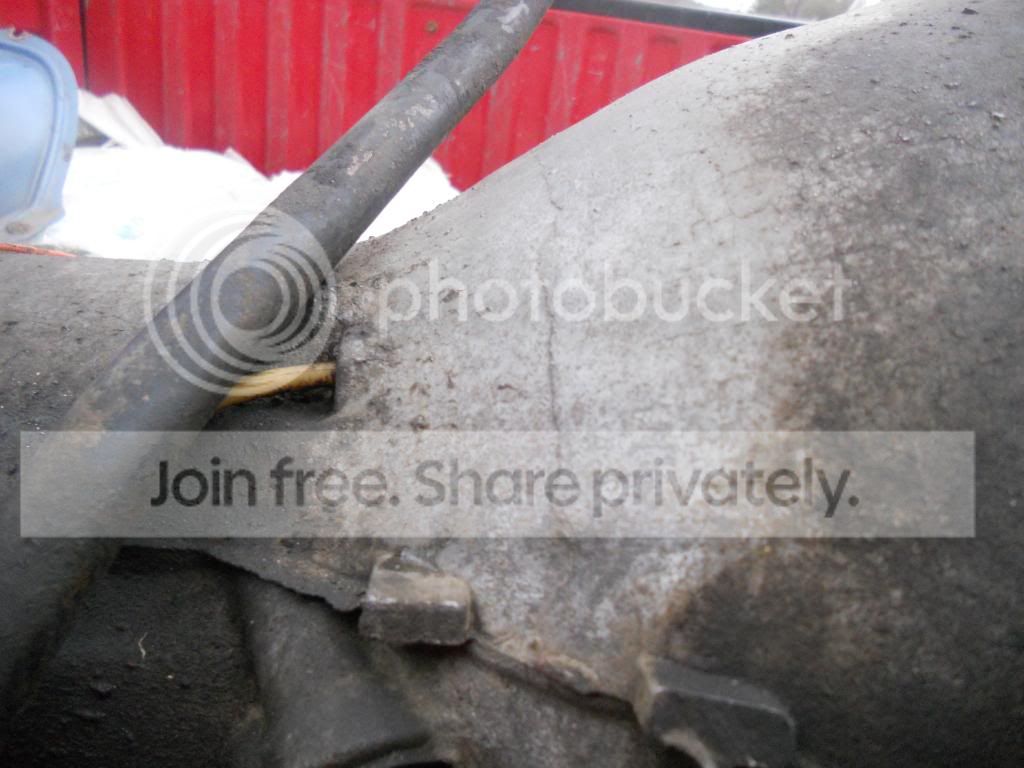

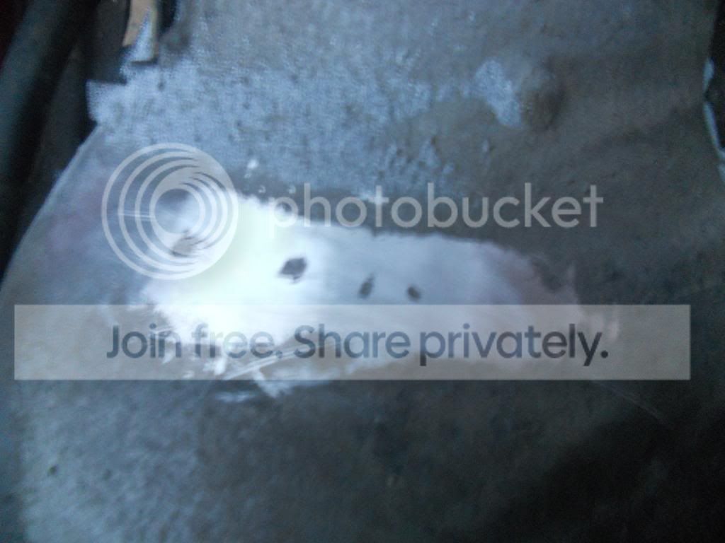

Okay i just picked up this th400 and noticed that there may be a crack in it, but i cant tell if it is actually a crack or a casting mark. I searched some other sites and found out its pretty common for th400's to crack in this spot...What do you guys think?
from what I can see it looks like it could be the casting, but if it was going to crack that would probably be the area.

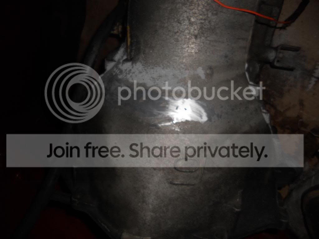

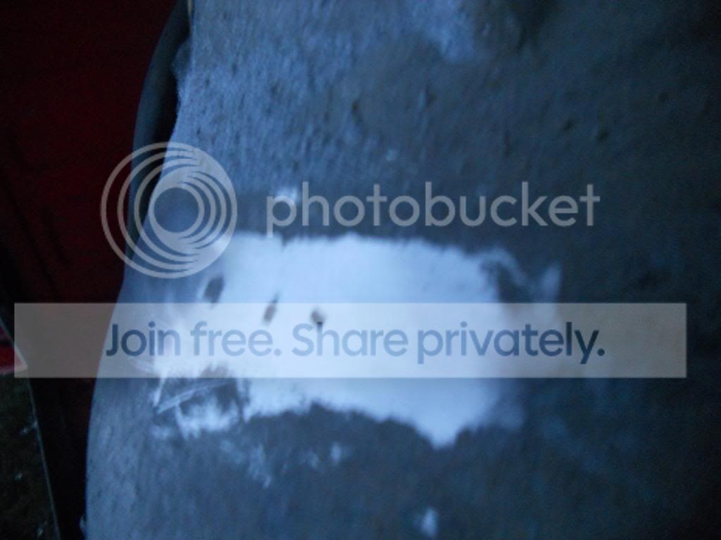

You could sand it down with some 150 to see if its just casting flash overlap, or if it goes deeper...if it does, grind it and Tig it!
What does the inside of the bellhousing look like?
You could mag it to find out if the crack is there or if its just the casting.
I'm sure a competent welder could handle the job, but it may be cheaper to find a used case.
