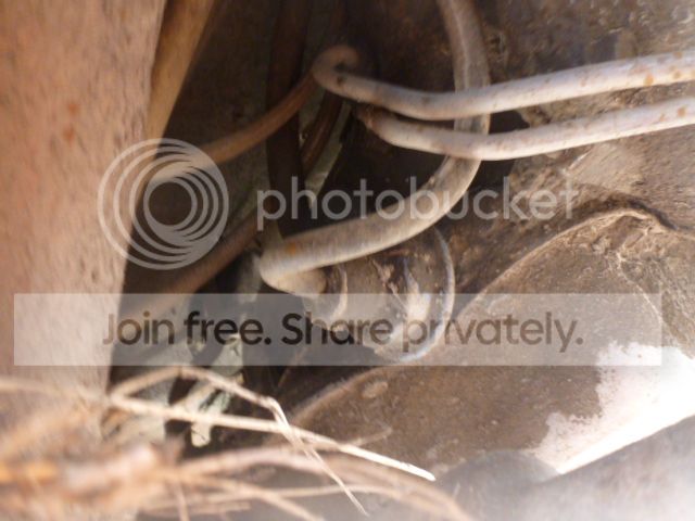

If this is the vac modulator...

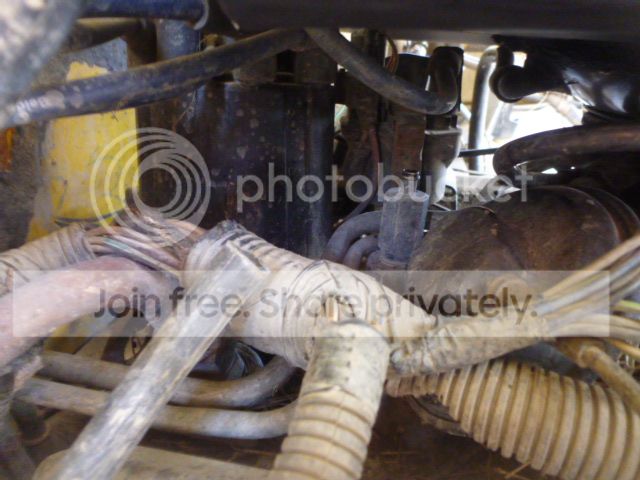

Then it is not hooked up to anything! You can see where the hose ends in this pic by the rotor and intake. I have no idea where its supposed to plug in and theres no sign of a busted line where it should have been, my guess would be the post behind it. Where is it supposed to be plugged to?
And the port on the bck of the intake goes into the valve cover as it alwyas has been
Well, theres your trouble right there!!
Yep, that is the modulator, should have a piece of steel line between the two rubber lines.
As to where it goes, you are going to have to wait for someone more familar with those setups than me. Its been years since I worked on one, and I don't remember ever working on that end.
What is that small black thing with the nipple on top just to the center right in the picture?
Looks like it might be screwed into the intake, and have a place for a hose.
It can hook anywhere where it is MANIFOLD vacuum. If that nipple is actually threaded into the intake and leaking, that is a massive vacuum leak. That is where the modulator is supposed to hook up to.
yep hook up the mod to that fitting, the breather pipe from the v/c is supposed to go to the air filter housing, and the pcv should go to the front of the base of the carb to a large vac port.
The truck is going to drive like a completely different machine once you get the line hooked up.
Right now the transmission thinks the engine is heavily loaded down and straining. So it stays in the lower gears as long as it can.

Well I stopped by my buddys place with that info in mind.
As soon as I put my finger on that nipple it was obviously a MASSIVE leak as the idle instantly smoothed out!
So I added a few inches to the line and hooked it up to that nipple and the idle improved even more as well as lowering the idle a bit
Then we went for a drive.... and holy cow! His truck drives like a different vehicle! It shifts so smooth now you can barely feel it and at any RPM.
