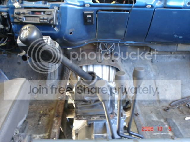

Definitely 4 sticks...

After all, you could always use a PTO too . . .:D Think that would be about the limit :eek1:
