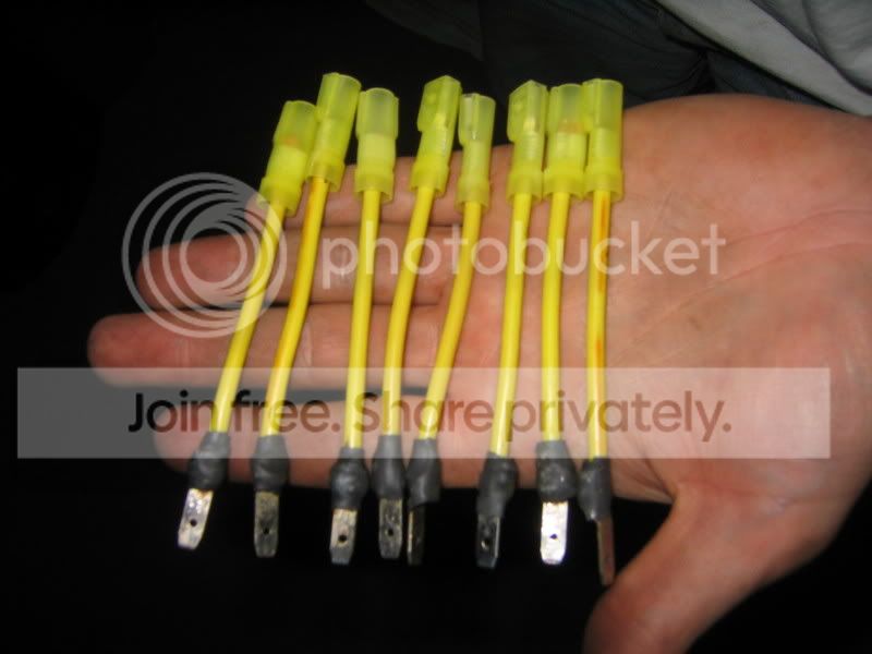

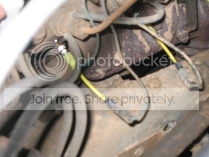

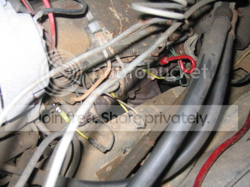

For anyone who is interested, below are the pics of my little solution. I was a chevy tech, electronics and driveability, and i try to avoid cutting up the factory harness whenever possible, so my solution was as follows.
I took the old glow plugs, used a pair of dykes to cut the flat blade terminal off, at the base, then used a grinder to take off the "stem" it was welded to. then i took some spare, large wire (larger than the factory harness), and the 1/4in flat blade connector. i drilled a hole.... forgot what size exactly, but small, in the old glowplug terminal, threaded the wire through the hole, soddered it in place, and put shrink tubing on it. then crimped the 1/4in blade terminal on the other end. using these pigtails i can run the ASP1110 glowplugs on the factory harness, and can go back to the factory ones should i ever decide without having to do any repairs.
oh and for the record, some might think that i did way to much work, and made this repair harder than it should have been, but i took one look at trying to cut, strip, thread, sodder, and shrink tube the harness inside the engine bay, between the block and frame, covered in grease, while i feel like ****. and the two hours it took me to fab up those pigtails, at a workbench, clean, and with plenty of elbow room, no sore back..... i would reccomend the pigtails to anyone looking to do the same thing.
