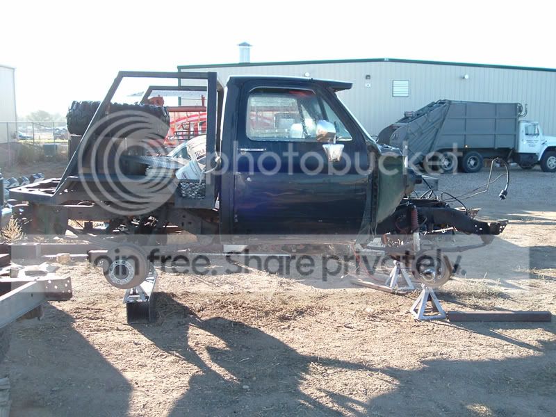

Hey Chris,don't see you on this board much (or out on the trails with the CO Crew at all! :shame: ) good call on the new cab, it was certainly one of the better decisions I ever made during the build-up of my truck. I spent so much effort into repairing rust on the blazer that it was incredibly hard to come to the decision to ditch the body, but with some persuasion from the crew here I made that decision just over a year ago...
Going from this:
To this:
Unfortunately it seems I'm too tuff on my junk and half-ton frames just can't handle it, so after all the work to make this...
...it ended up like this
So now I have moved onto a '79 one ton frame with a conglomeration of parts from every vehicle so far...
Oh yea...and good luck with the project! :thumb:

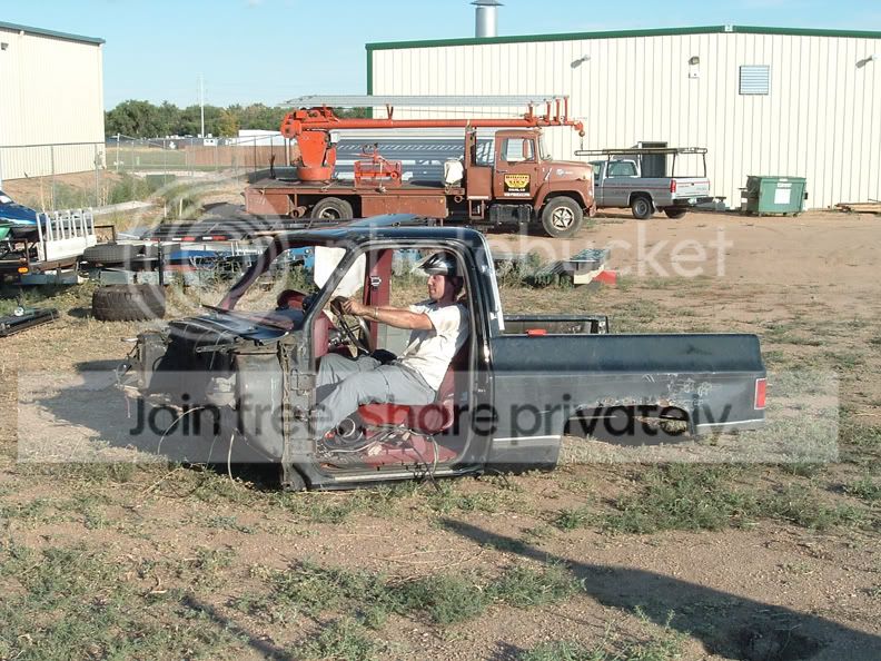

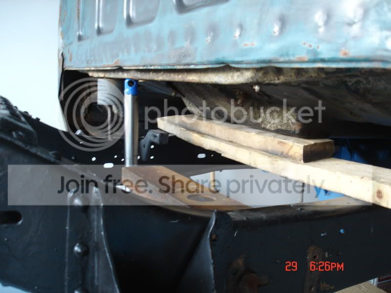

trazer
I am building a trazer right now. I posted the same question you did a while back. I have a 85 k5 frame with a 82 cab. The front cab mounts are the same but you are going to have to build a rear cab crossmember to support the rear of the cab. The truck frame crossmember cab be modified and used and this gives a nice stock look. mine is built of c- channel and then I had to cut it in half to fit it inside the frame rails. I'm still waiting for someone from my club to help me weld it in. I think when I get the cage built I will tie the rear cab supports into the main hoop. This pic shows half the crossmember before it was cut and raised higher. The cab is siting level in the pic.
