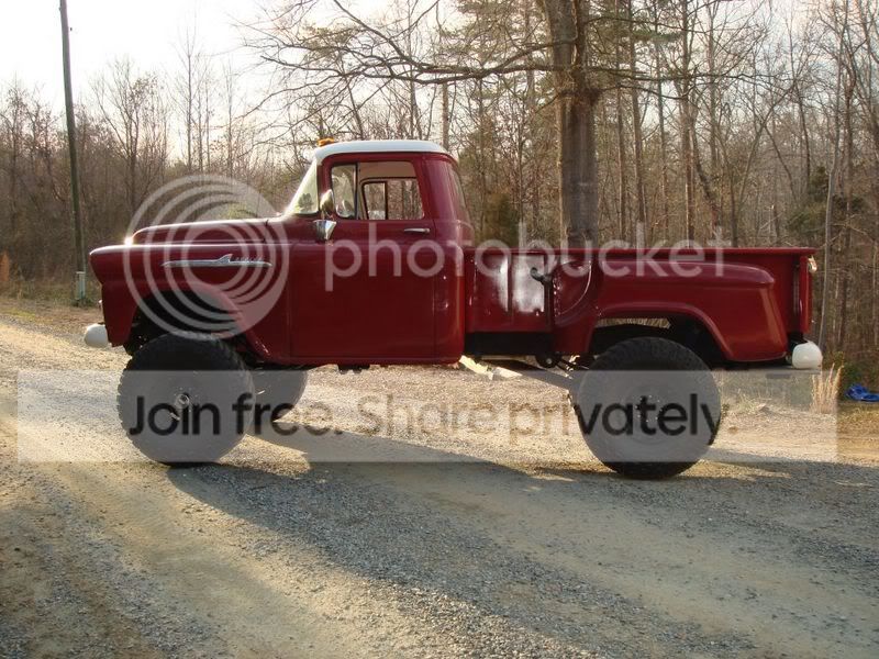

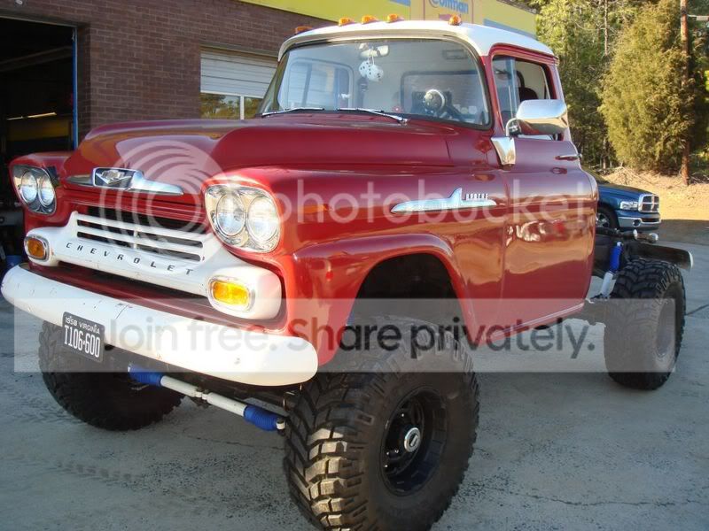

58 chevy body
custom guages
blazer buckets
tilt
ps
pb

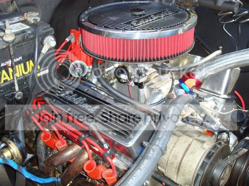

400sbc
.030 over (406)
speed pro coated dished pistons
forged crank
h beam rods
internally balanced
pro comp aluminum heads 195 runners 202 160 valves
5 angle grind port and polish bowl blended
234 242 516 525 @.050 110 lobe sep
1.6:1 roller rockers polly locks and stud girdles
holley dominator intake
edelbrock 750
headman headers
flow masters
built th350 3000 stall
np208

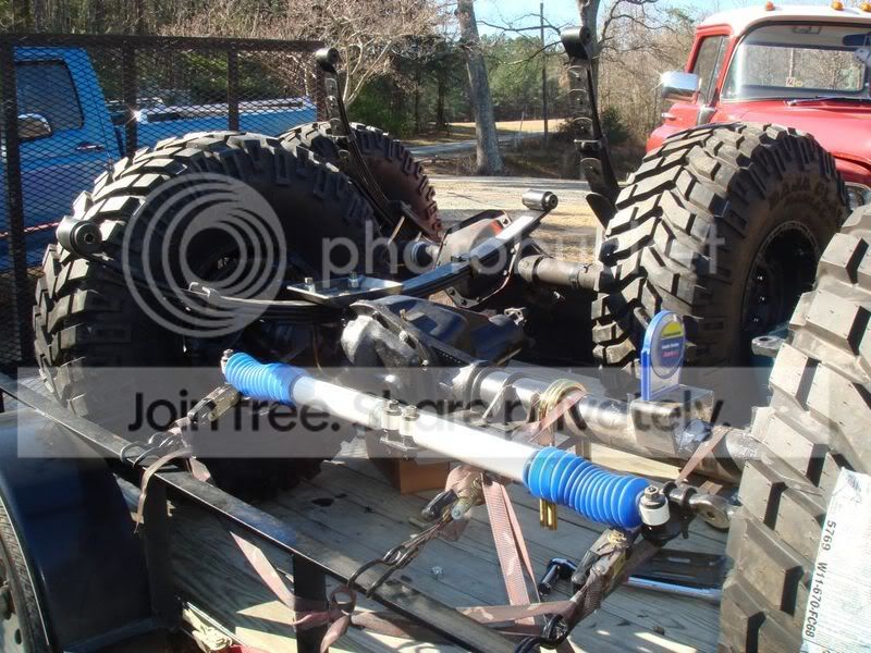

14bff 4.56
d 60
ez ride 6" lift 3" body(to clear bell housing)
37x13.5 mt
428 horsepower @ 500
525 lbft torque @ 3800

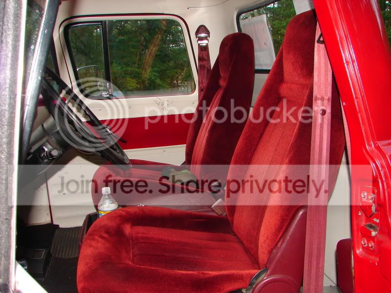

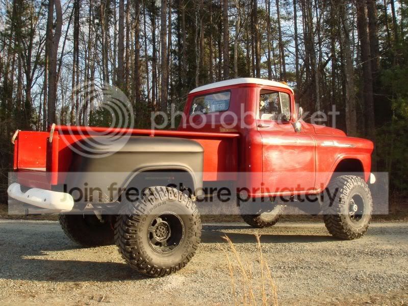

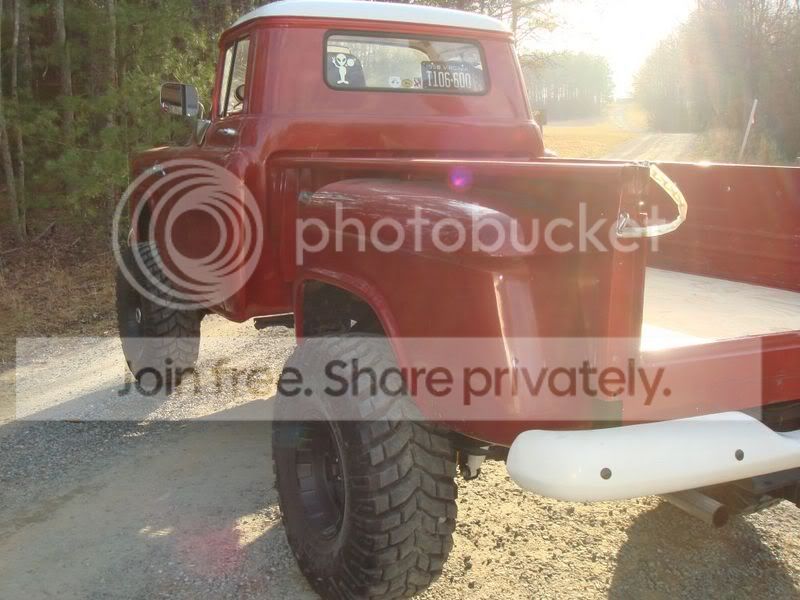

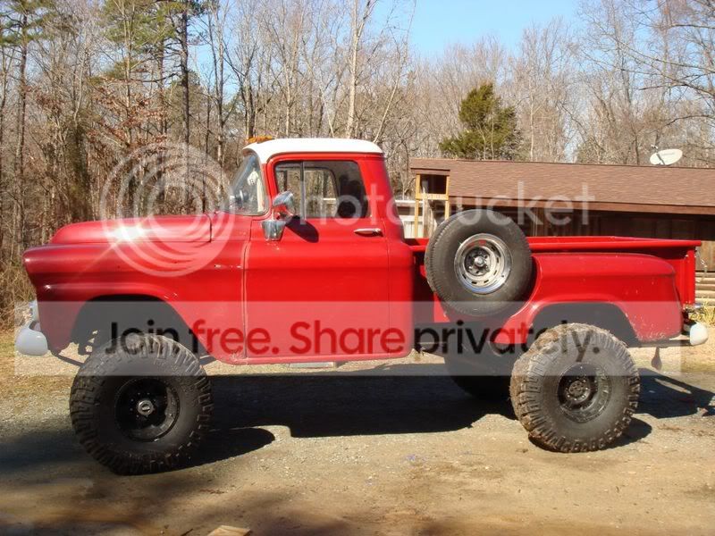

heres some various pics
