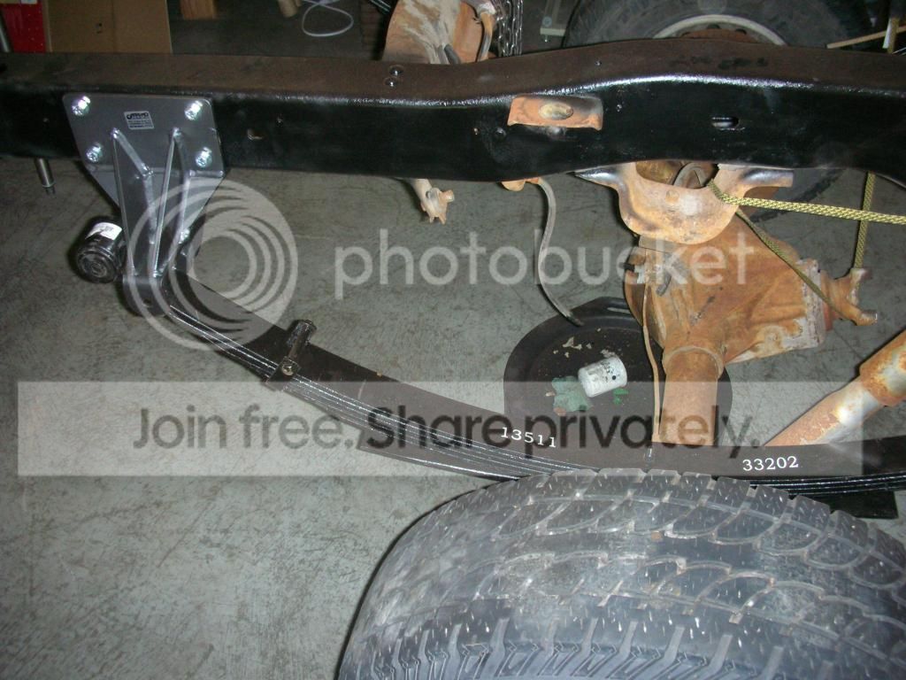

I went with the long leaf kit for the front from DIY4X. Put Pro Comp 52" springs with it. the rear i went with the shackle flip kit from Offroad Design and used Pro Comp 56" springs. I was luck to be working with a almost bare frame. i ended cutting off one of the old springs at the eye, i messed with it for several days using PB Blaster and brute force before i decided to cut. :popcorn:

So Drumming is real busy right with work so I'll throw in a few pics I took
