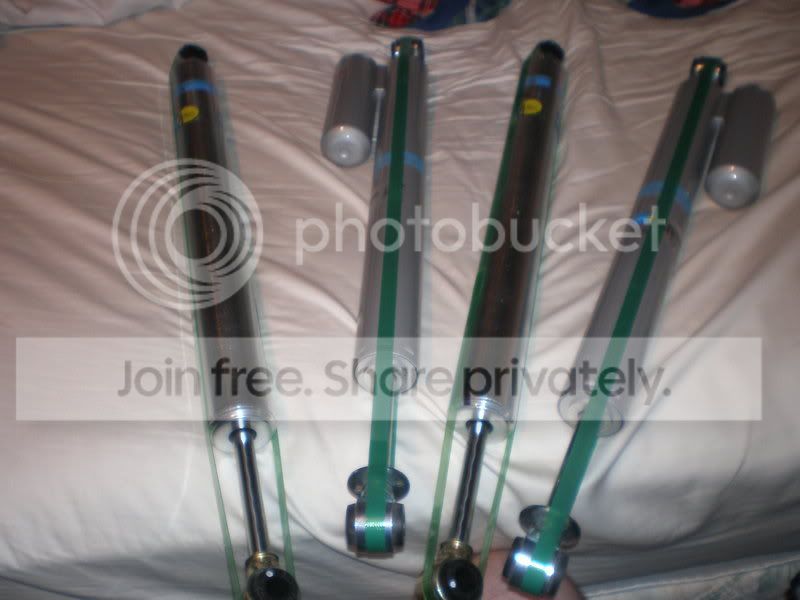

while I was at work and left me these goodies...

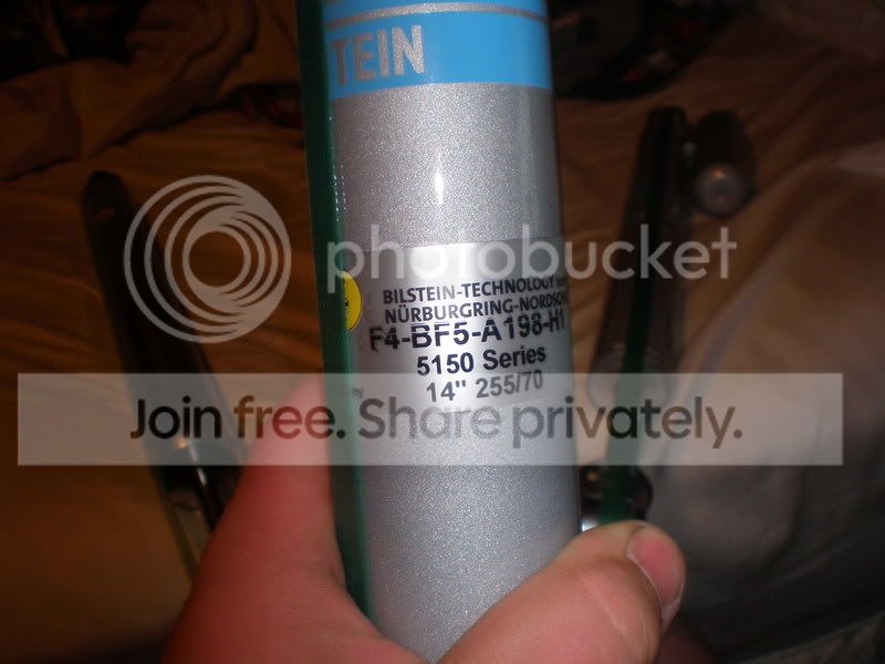

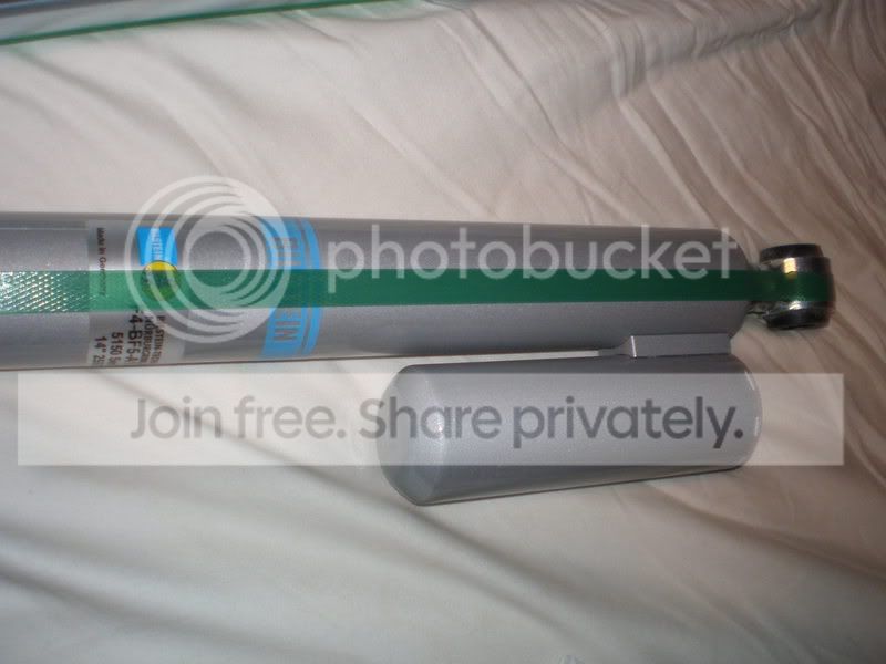

Bilstein 5125 for the rear and Bilstein 5150's for the front...
Mono-tube nitrogen charged so I can run them "upside down" (with the body at the top) in order to clear my steering linkage...
14" total travel

But it really doesn't matter now b/c these bad boys can run up, down, or whatever way I want and not only will they not leak they'll perform the same no matter what position they're in.
Oh BTW props to Scott (username machinewave over on pirate4x4...Trail-Gear dealer)...it was like $390 for all four of them (two 5125's and two 5150's) shipped to my door...I ordered them Monday during my lunch break and they were here (wednesday)...thanks!

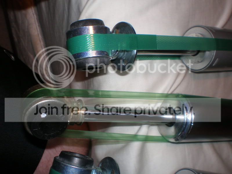

These were a PITA! I couldn't compress my springs enough to bolt them up with the straps on so I had to cut the straps off...bolt them on then compress the shock (took my dad and I) then bolt the other end on.
