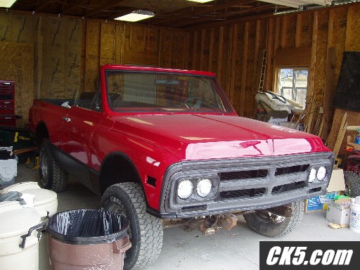

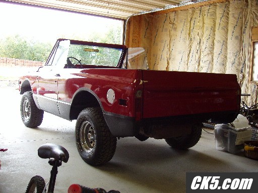

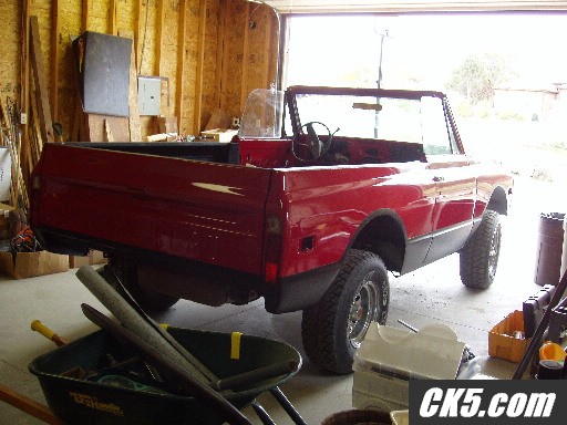

A couple engine swaps and transmissions later I decided it was time to build it for offroad and more dependable driving. First order of business was body work and paint. I stripped it down and paid to have it hauled across Colorado to have the body work done, after 6 months that shop shut down and they paid to have it hauled back with no work done. A friend helped me cut the fenders and tangs off the front and made the front clip one piece by doing a ton of welding on the front inner fenders. Took it to a local body shop and sourced a bunch of parts. They tubbed the rear fenders, changed doors using cut down truck doors, body work, paint and speedliner work followed.

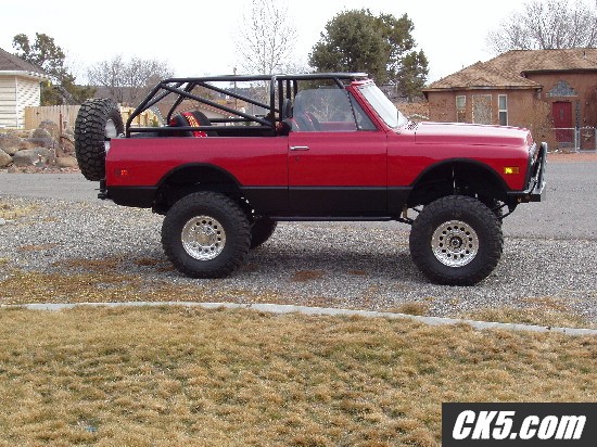

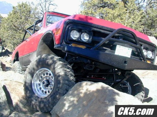

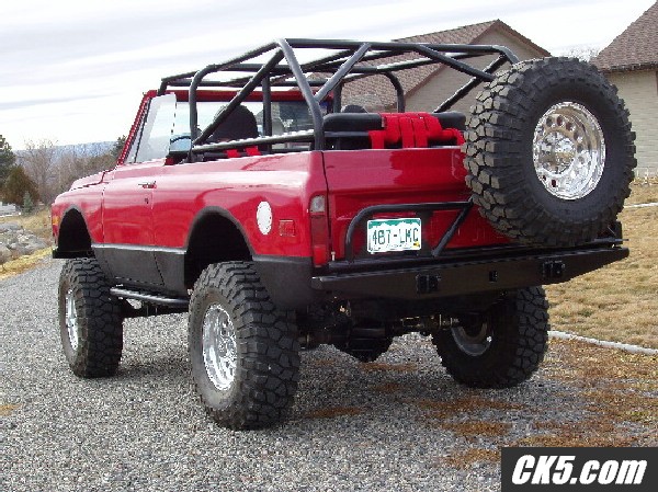

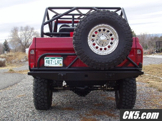

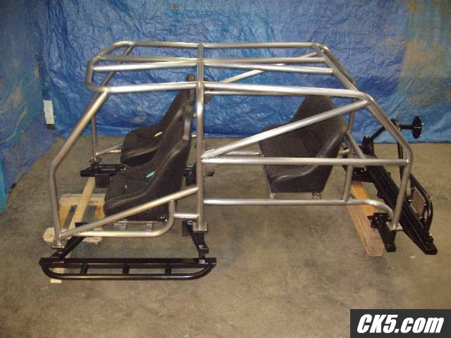

Next it was off to a welding shop in Crawford Colorado, a former member here, Metal Melter and his father, and I designed and built the cage, sliders, and bumpers. I wasn't a great deal of help. The cage and sliders are 2 inch .120 wall DOM, along with rectangular tubing. DIY4X staked cage floor plates were used to connect the cage to the sliders. The bumpers were also rectangular steel that was cut, bent and welded. PRP seats were purchased along with RCI harnesses.

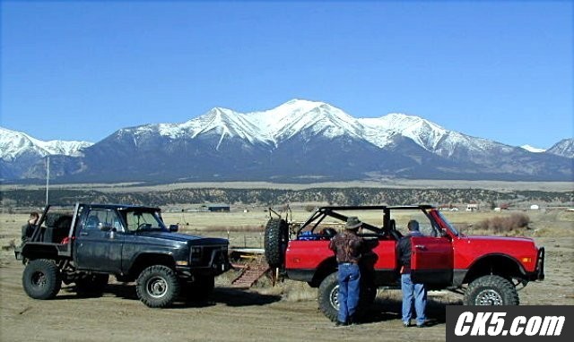

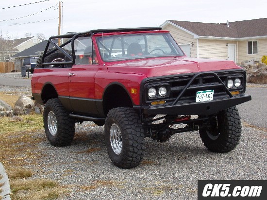

Then it was back to a friend's shop where the 10 bolt front and 14 bolt rear were put in along with changing pinion angle, shock tabs for the rear axle, driveshafts, and the rims and tires were installed. At this point it had 37 inch BFG krawlers which were run until 2022, various replacements were obtained from multiple sources.

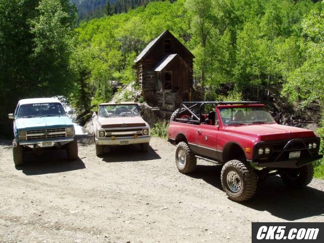

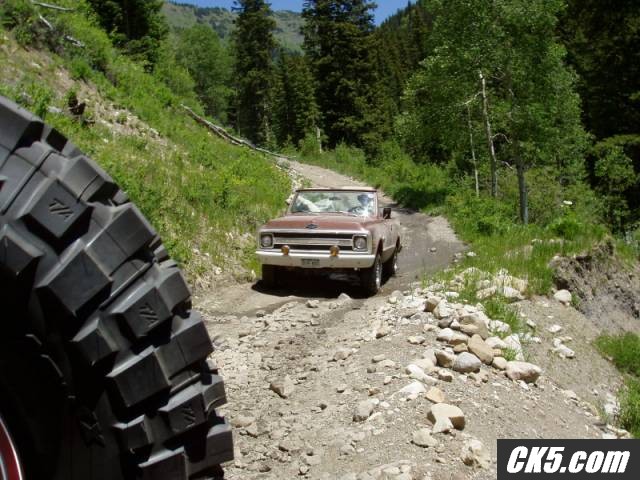

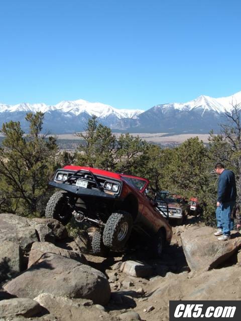

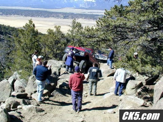

At this point it was somewhat roadworthy, so I met up with Mrk5, 3 on the tree and several others to run Old Chinaman's Gulch near Buena Vista Colorado. The carb was cutting out and I received a dent in the fresh paint and broke the steering arm off the knuckle. The vehicle was left on the trail while we ran most of it then we came back and repairs were performed by various people in the group, steering arm was ground down and battery welded to the knuckle. Vehicle was limped back to town and I stayed in the motel so it could be driven home in the daylight. Pics from the trip.
DIY4X: Staked cage floor plates, 360 degree tube tab rings, tire carrier, gussets.
Offroad design: tuff country EZ ride 6 inch lift springs 2 sets for rear since I ruined one set. Shackle flip, extended shackles greaseable bushings,

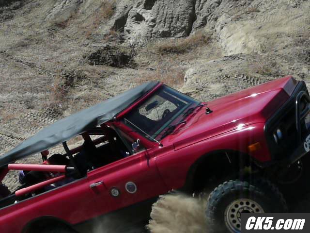

Next it was off to the upholstery shop for a couple custom made tops. The cage sits above the windshield frame so the hardtop was ditched.

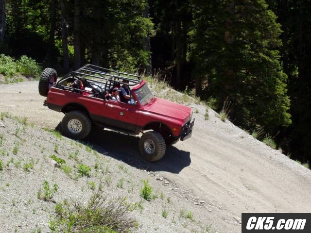

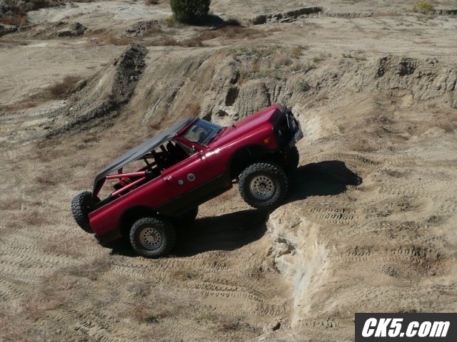

Experience in off roading was slowly gained, still learning, with a few more trips, a car show or 2 , and even a mud run.
