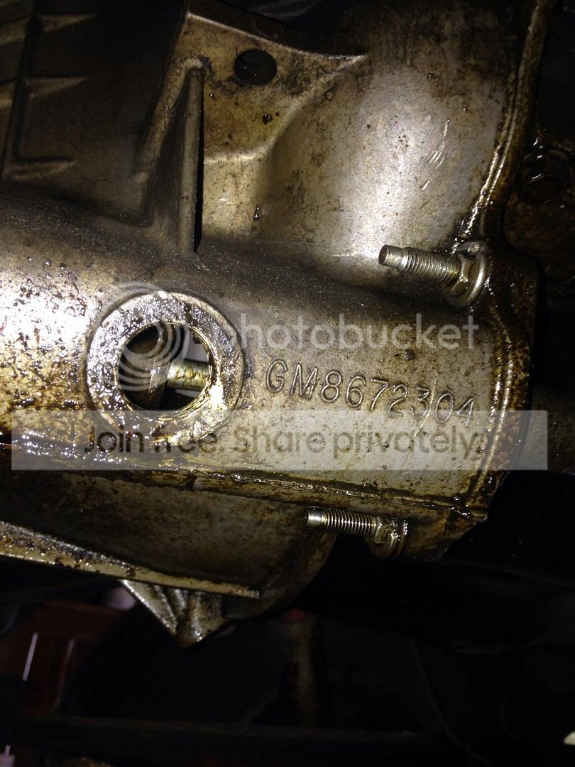

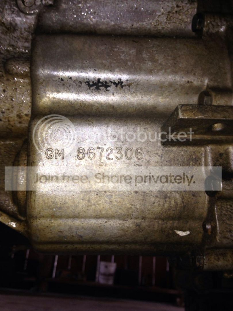

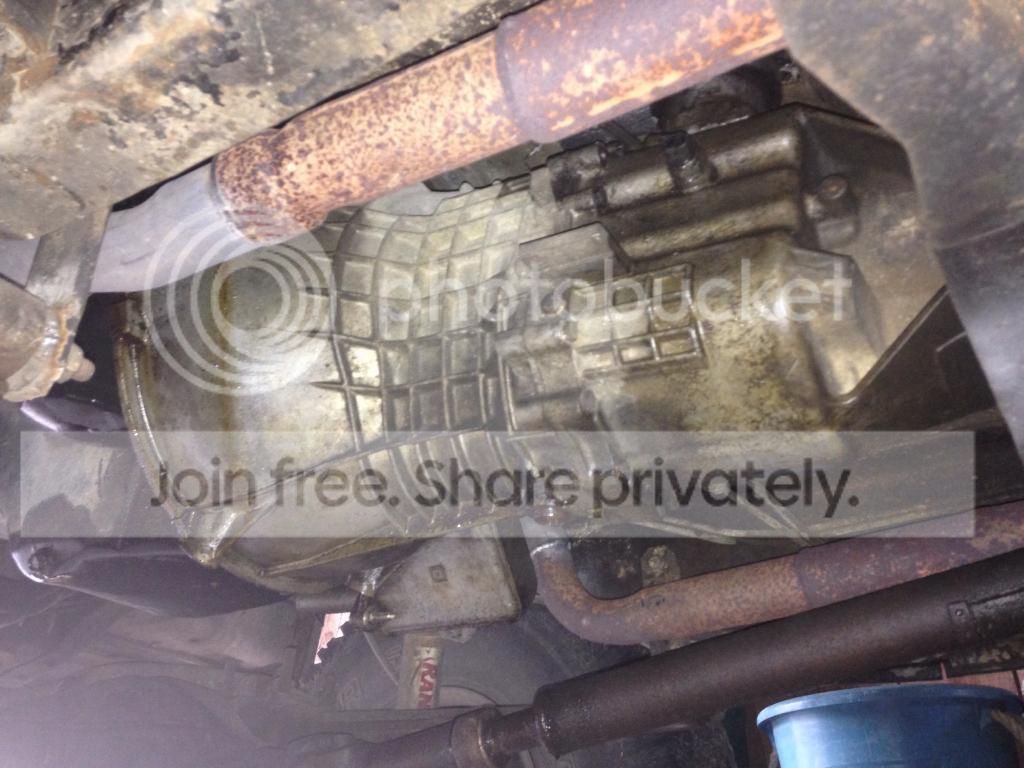

...didn't think to include a few pics to help ID this trans. I also found these two numbers on the housing but didn't have much luck finding anything specific when I looked them up.

And yes thats definately a nv3500 variant. Figuring it out isnt really worth the time lol. Run it until it blows and if you liked it upgrade to a later unit with an internal throwout bearing.

Any idea what that hole is for in the second pic? Makes it easy to see the slave cyl working, but doesnt look like there should be a hole to let trash in there..:dunno:

I'm sure it should have a plug of some sort in that hole.
It's threaded. Guess it would be worth it to hunt down or make a piece to plug it right?

I seem to remember it having that hole. I still have the truck sitting around, curiosity my be strong enough to go take a look. I do remember there was a grease fitting for the fork pivot stud.
