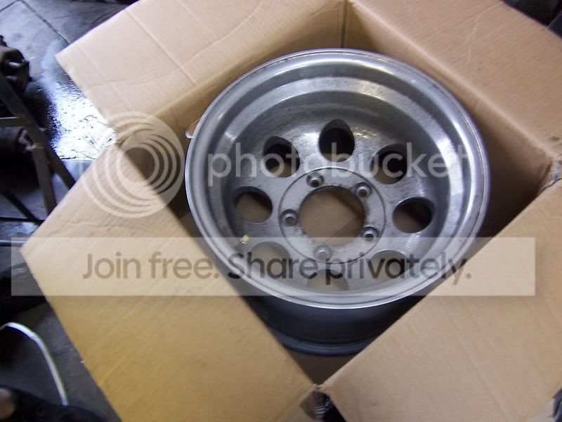

how would i polish them to make them look brand new? can anyone recomend what to use i have a high powed hand buffer.

Before

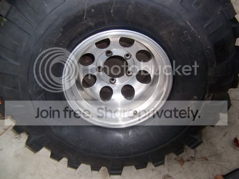

This is before the polish too...
I use mothers aluminum/mag wheel polish. I have done it by hand many times, a mothers powerball would work wonders.

well i tried the rubbing compound and the mothers mag/alum compound with a 3hp buffer and it just cleaned them they still dont look good. i think the enamel <clear coat / laquer> is whats coming off. should i bead blast them w/ bakeing soda? then polish then spray?
I had those alloys stock on my'87. You need to get the clear coat off first, then polish like any other polished alloy wheel. I used paint stripper from the parts store to remove the clear. After I finished they look almost as good as the ones above. If I would have had a power tool to do it, it would have look as good.
I had the same look alloys on an '89 and they were not a smooth polished wheel surface. More of a machined surface. Those will never polish out to mirror finish. So sometime in '88 or '89 the wheel changed.
