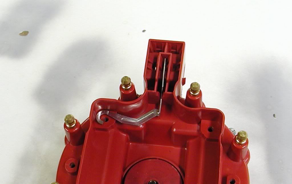

ensure you did not forget the ground strap between the cap and coil...like I did many moons back.
