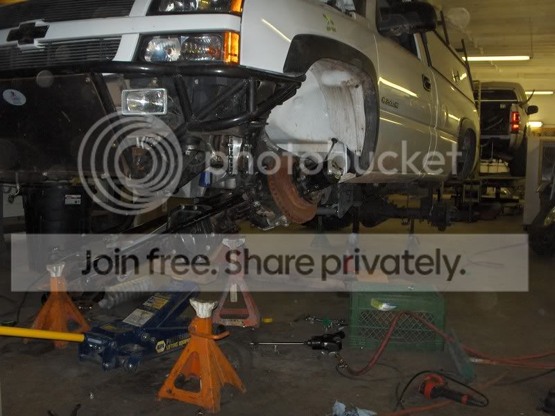

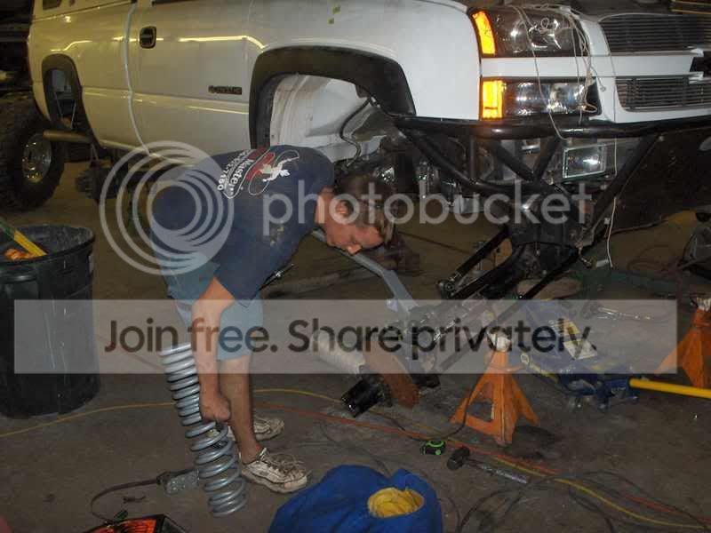

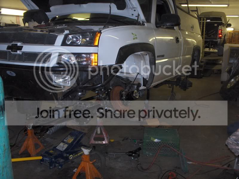

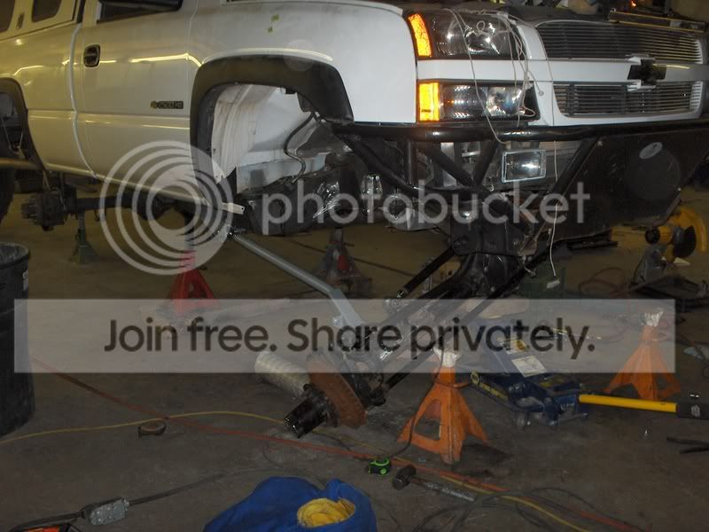

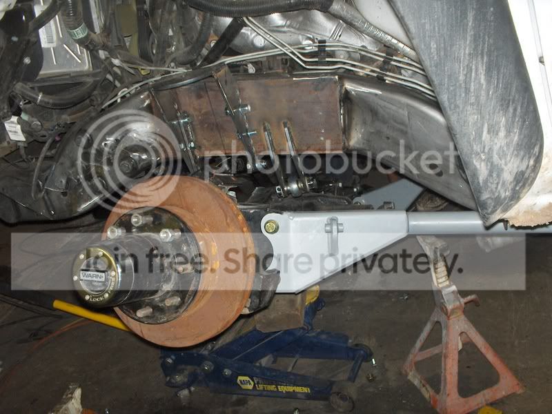

the springs I recieved are way way to soft, the wheels offset puts the tires right into my arms and the truck needs to be finish welded here and there, add the brakes, missing pieces and such and I am not getting any where.

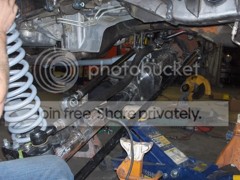

Are you going to put more side to side triangluation on the axle track bar mount? For a little comfort I would put some more on the frame mount too. Great work.

the track bar mount also goes to the backside of the frame, every thing still needs some final welding

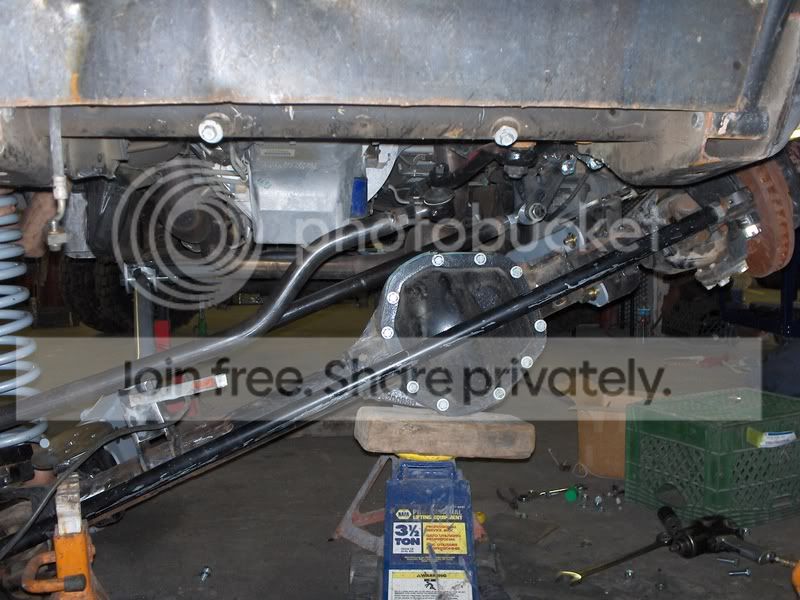

I got some real good help from travice and another friend so its almost there but there are some serious bugs to work out. also cant decide if I should just go coil over, try some superduty springs or??

On the springs, just need to check what the rate is on the ones they sent you and go from there. I'm still thinking Aaron's idea of big block bronco lift springs would work.

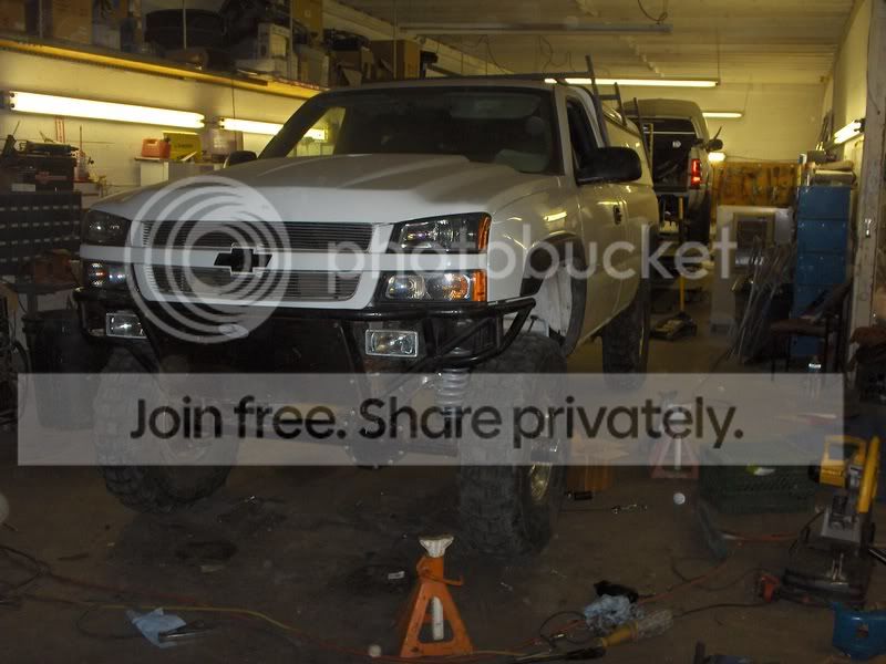

hmm spring you are on you own but i think the 42's look nice
I love the way the 42's look, but they are bias ply and for the buggy..I 100-200 miles depending on what im working on that day so that would be a bad choice:crazy:

I ended up not being able to use the springs, brake lines are repaired reflared and rerouted
used some million year old yellow mystery lift coils from a ford till I buy some different ones or maybe go coil overs, these coils are alot better though. thinking about the procomp coils for the superduty.
well I just drove it 15 miles to a friends and 17 miles back:what::dunno: dont know where the two miles came from lol
anyways,,rides nice, set the toe on the front, I decided to get some sleep tonight so I will do the motor cage and shock mounts tomorrow night..
It tracks straight down the road and stops straight!! interesting ride with no shocks though lol turning is nice as well.
