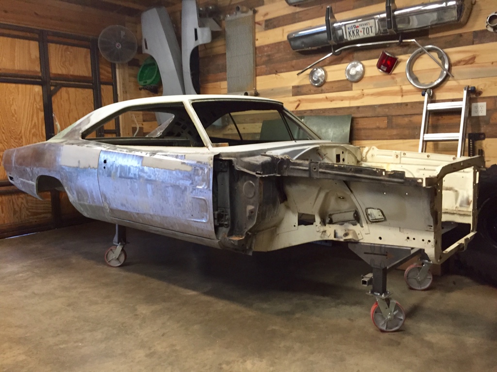

It's fairly complete - interior, trim, mouldings, lights, glass, suspension, drivetrain - really a rolling shell with no engine or transmission; perfect for my purposes.

Having never disassembled a Mopar, I started cataloging and bagging and tagging the screws, clips, brackets with detailed notes as to how they went together and where. The reprint service manual was a useful guide. I should also say that every project - garage, house, car - is a chance to work with friends and family. Here's a buddy helping me take out the suspension and get it loaded up in the body cart:
Disassembly would move along nicely from this elevated height:

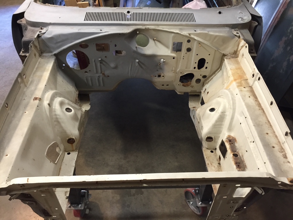

I spent a good bit of time pulling the last of the underhood hardware, and took apart the driver door trim, and can now add at least a passenger rear quarter repair panel or skin to the AMD shopping list.

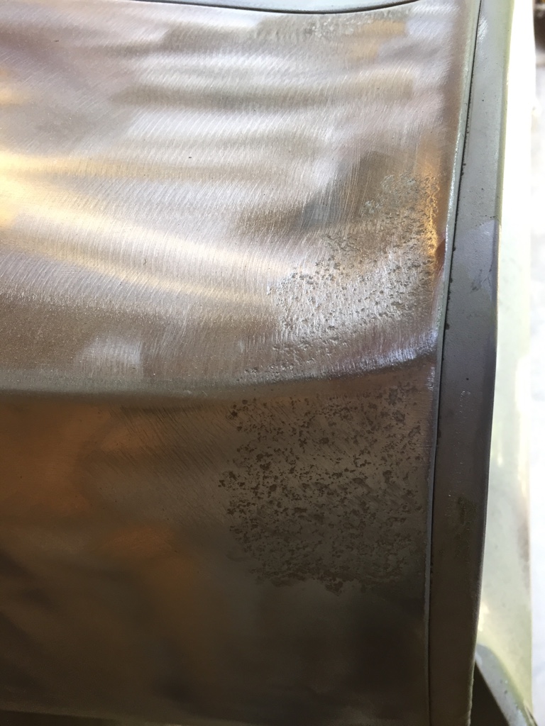

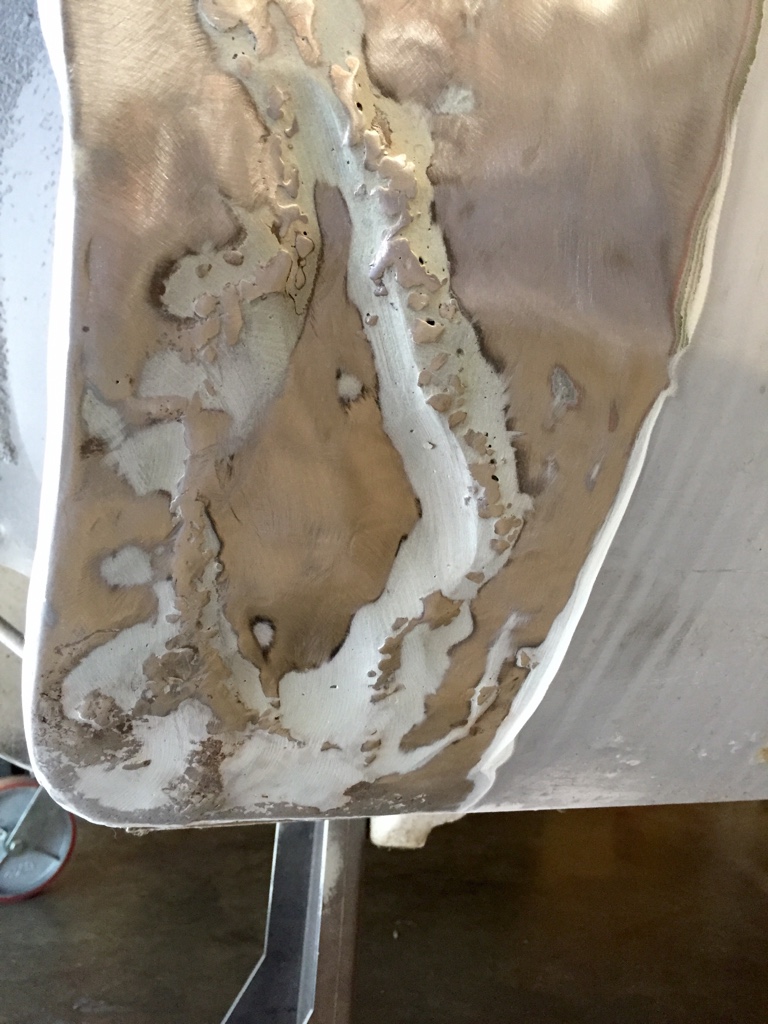

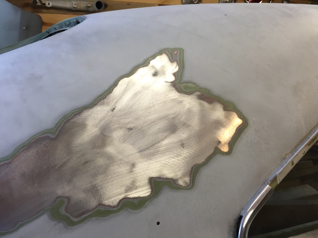

Quick shot at what happens when you stitch too quickly over rust, and try to cover it up.
Interestingly, it looks like both rear quarters are leaded smooth to the roof skin. These would be the original quarters.

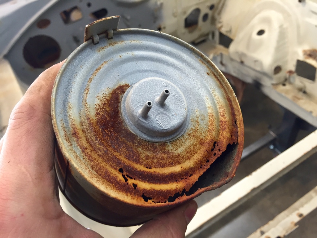

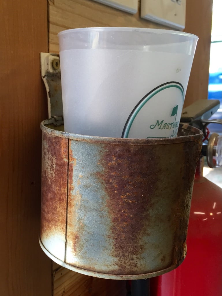

Finally, I can't stand throwing out parts; even the useless ones. Here's a repurposed vacuum canister:

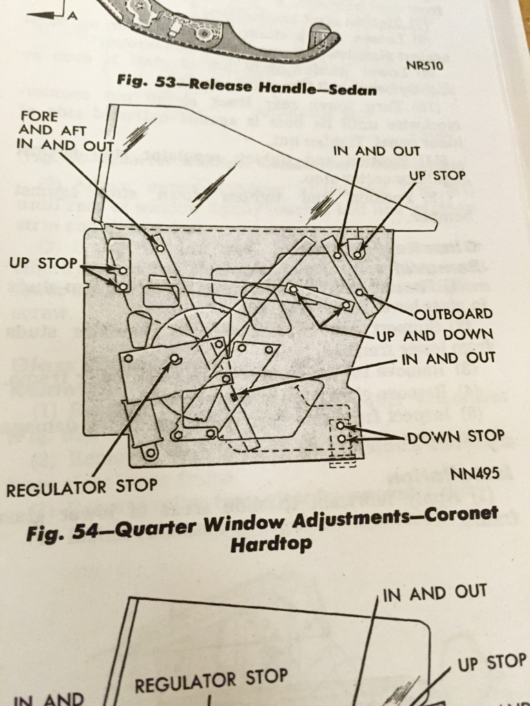

Got the passenger quarter glass out, and in the process learned why we don't see rear quarter windows anymore - what an intricate mechanical system.

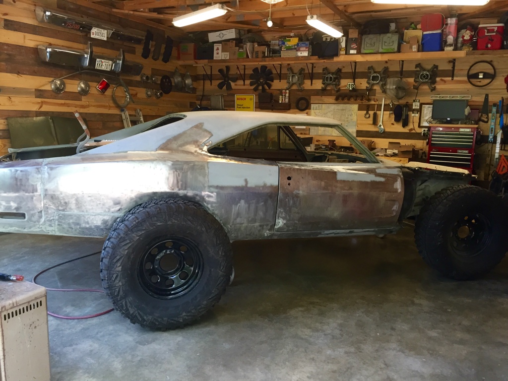

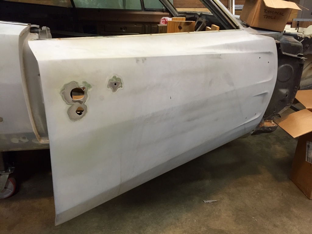

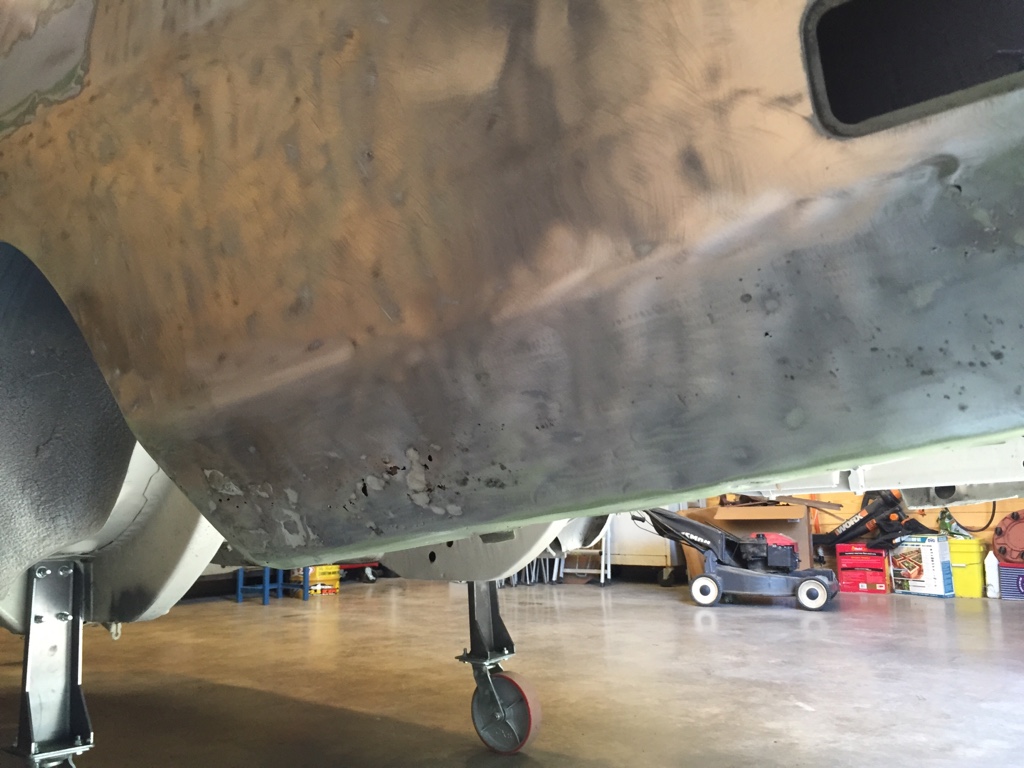

Sanded the majority of the passengerquarter and door, leaving behind only the non-bodyfillered sections.

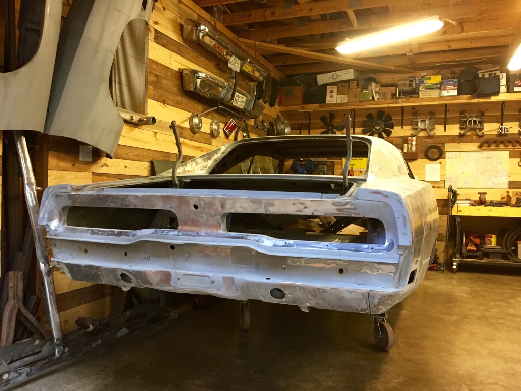

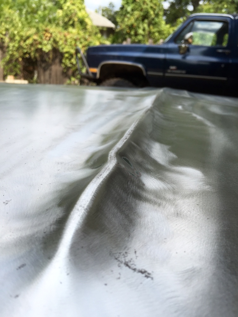

Also pulled the trunk lid and rear bumper and found more hack-job body work. The PO must have blasted or stitch welded without pausing, because there's a serious warp in the rear deck filler panel.
And while our state fair is still a couple of months away, the 3/4" bondo sculpture artistry on the rear valence corners was impressive. Blue ribbon.

All this sanding is building toward a general media blasting for the interior and wherever my grinder doesn't reach.

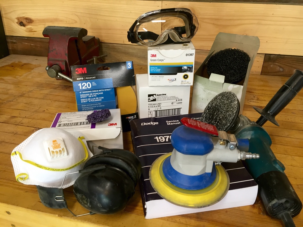

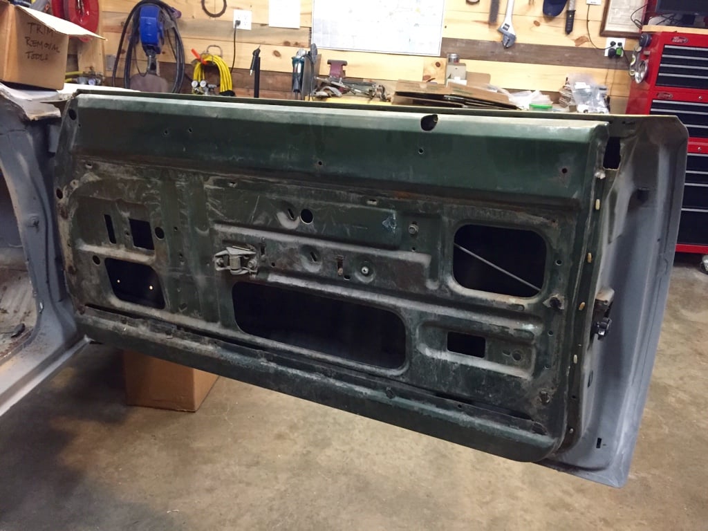

Pull the trunk torsion bars, driver door and quarter glass, and a lot of miscellaneous bits as I did my once-over to make sure everything is removed. Still need to pull the rear glass frame, but that's about it for mechanical. The shop that will be doing the work recommended scraping any undercoating/sound deadener and seam sealer. In an effort to save a few bucks, I'm sanding the large panels myself.
Quick note - I learned I was accidentally brand loyal. All 3M abrasive products:

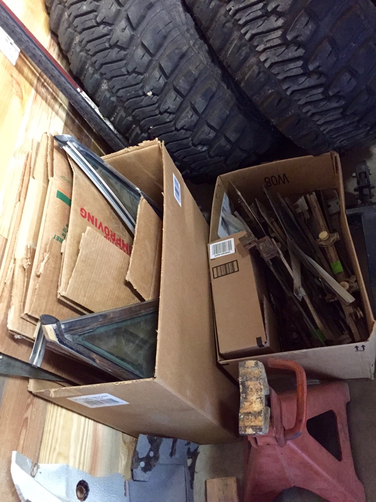

I did take a minute to organize; can't think straight if parts and tools are strewn about - work space reflects the mind space. Glass is packed and window mechanisms are carefully labeled and diagramed so I can put this back together a few years from now:

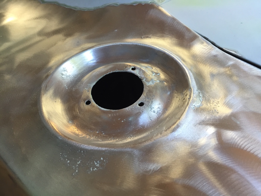

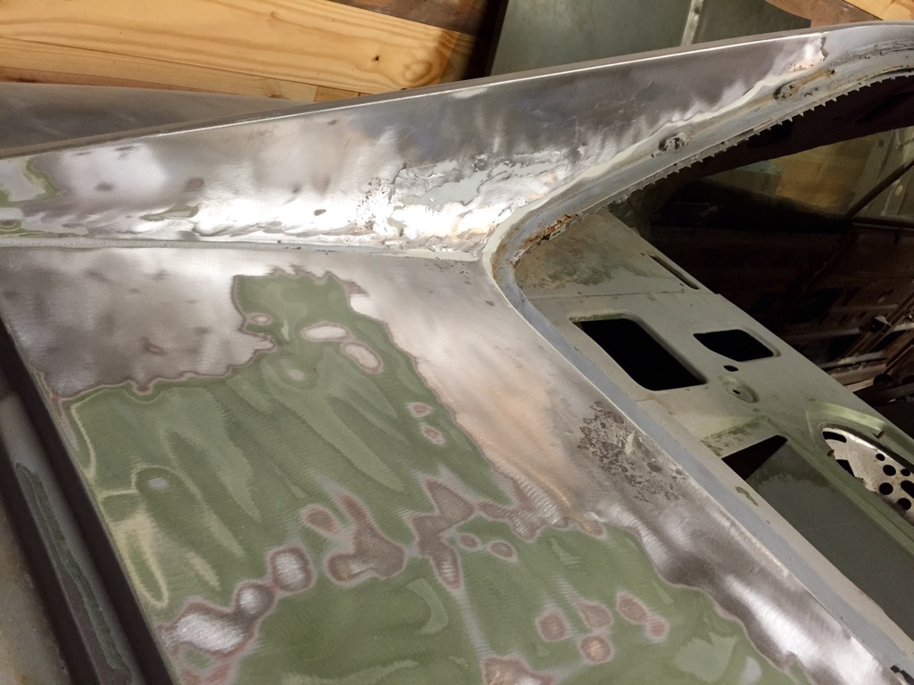

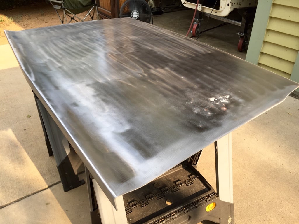

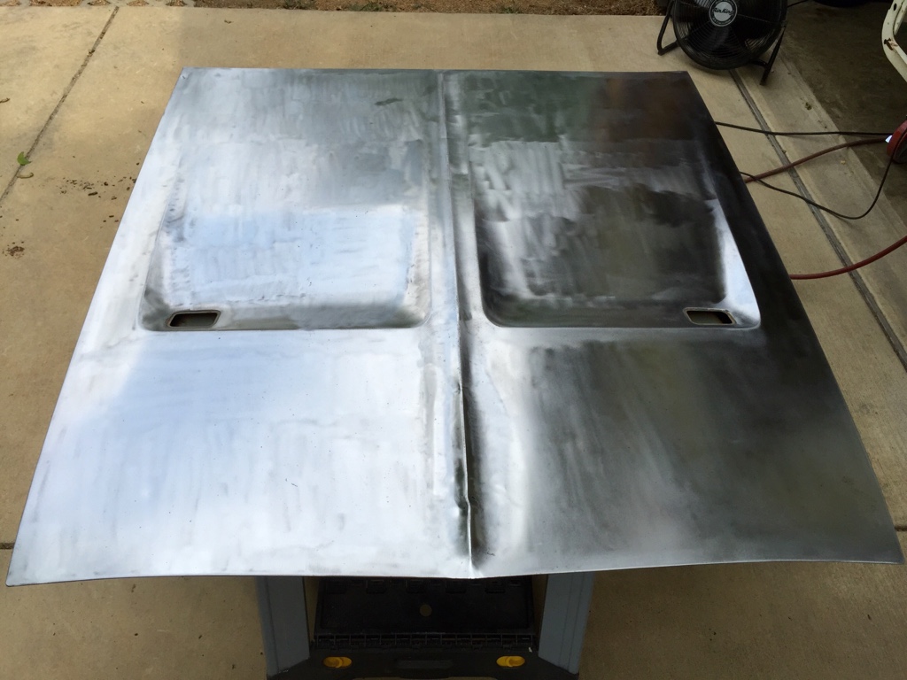

It doesn't look like much, but the door and hood represent about 5 hours of continuous sanding with the 3M pads and 80 grit on the DA. For the hood, it's the first time the steel has seen light in 45 years:
Note the damage. I think someone slammed down a heavy box or something:

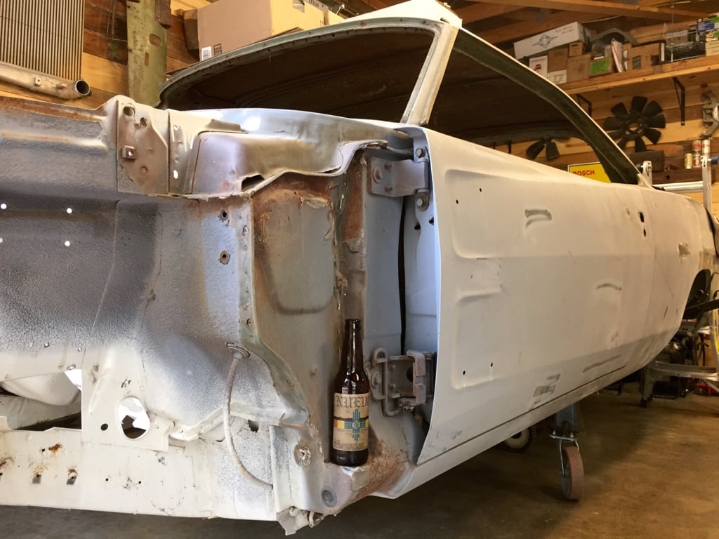

Handy at the end of the day, I like the integrated b-body beer holder:
