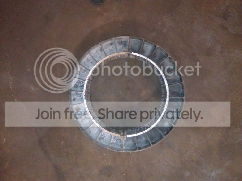

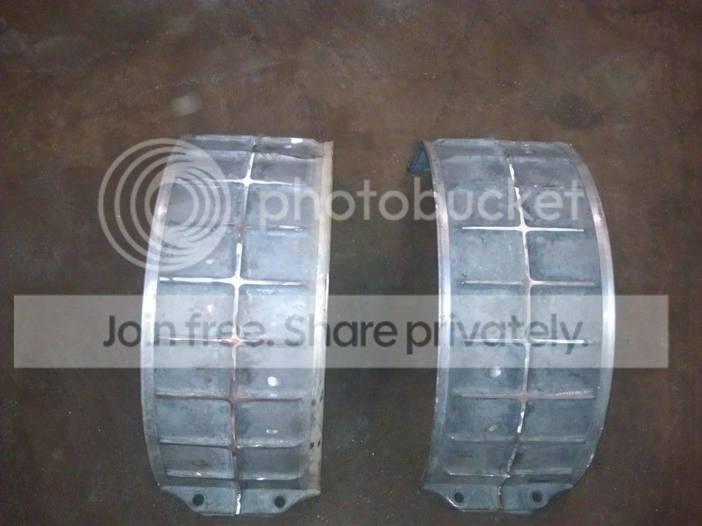

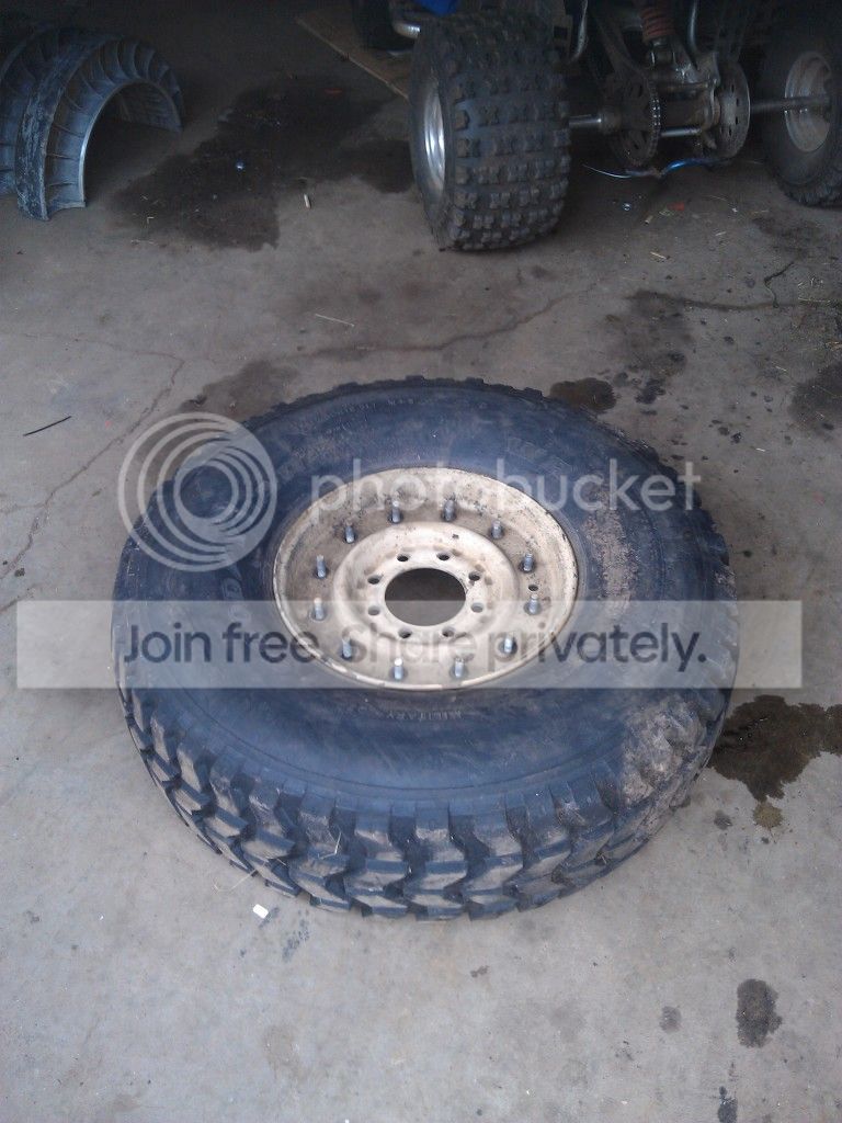

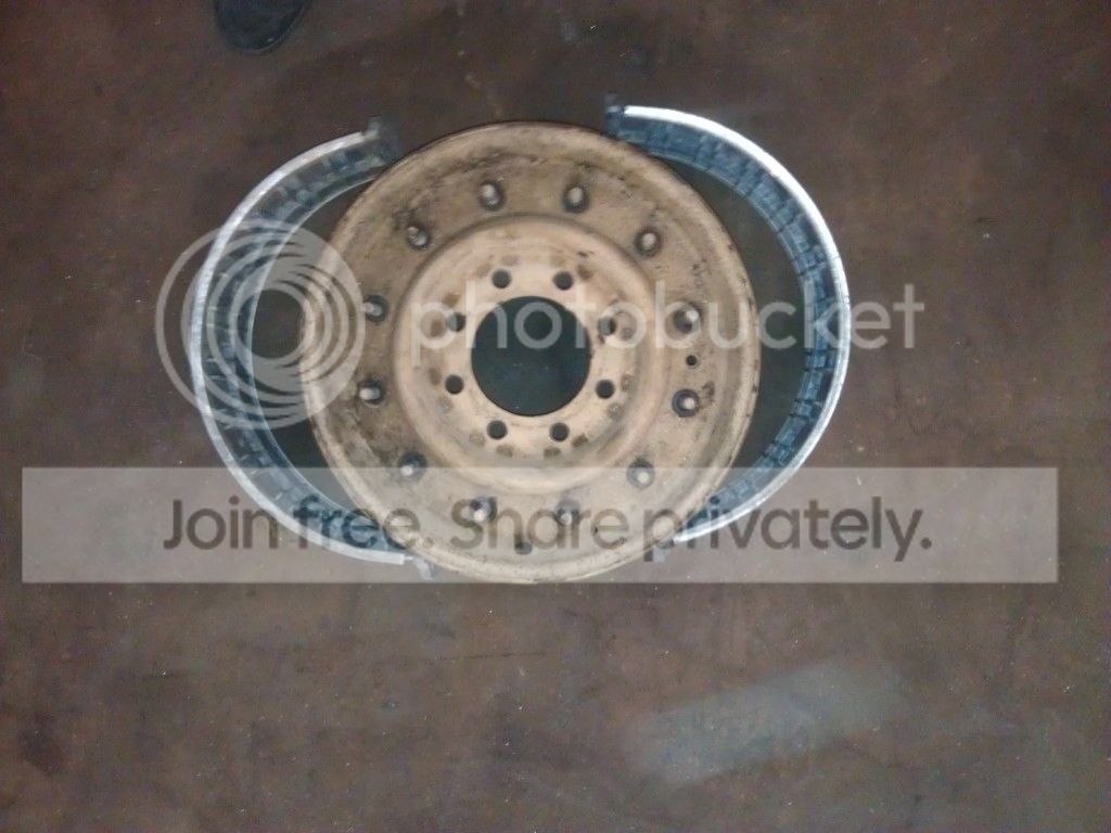

A few weeks ago i picked up a set of H1 wheels with Mag runflats for $180:woot:. Now I'm starting the process of cutting down the runflats and getting ready to recenter the wheels. The list for this winter include :Mod wheels and runflat, Install new clutch, Install hydro bell, and if funds allow install crossover steering. Has anyone run the mag inserts with the 37" radial? any issues I will run into?:dunno: Thank you in advance for any information.
