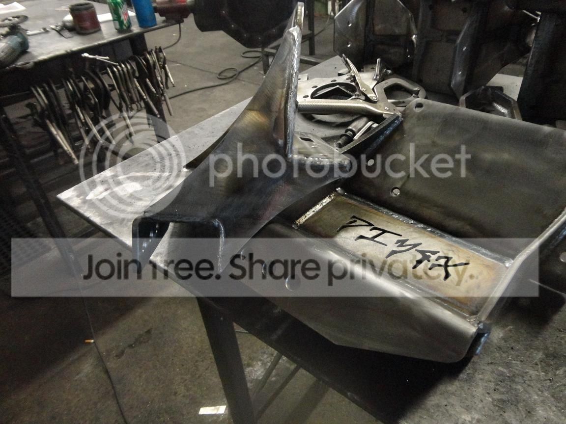

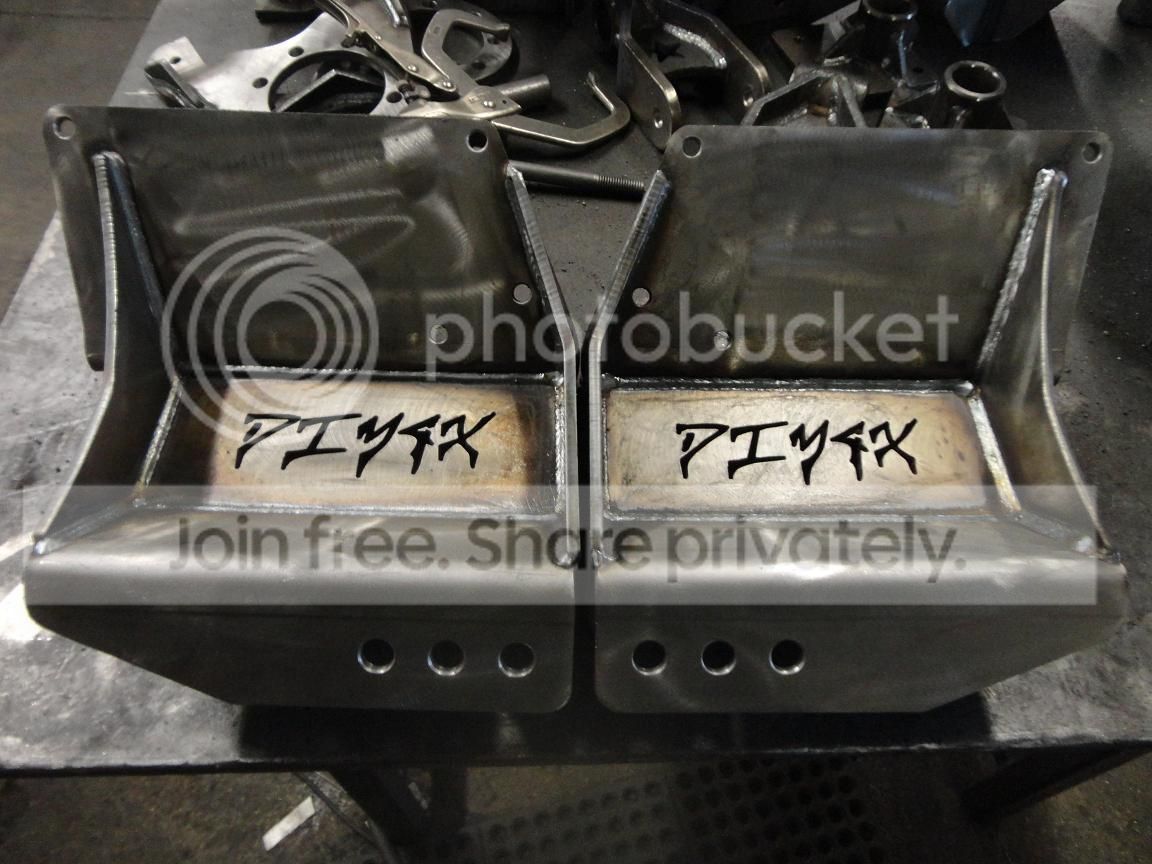

We've played around with these for quite some time now. Done them for some Blazers and some pickups. Don't think we've done a burb yet.
Kind of a mess of options with these hangers. Standard replacements, 1 ton perch spacing conversion and now, 6" forward offset for the 64" spring swap.
explain
these are the forward hangers for the rear springs? I'm running 56's meow, if I swap my stockers with these (set up for 6" forward) I can run the 64's? Only 6" forward?
Yep, these are the Front hangers for rear springs. Customer is switching from either the 52 or 56 to the 64. Can't remember which but doesn't matter, front half of either of those being the same length. Makes the adjustment 6". These are pretty much a bolt on.

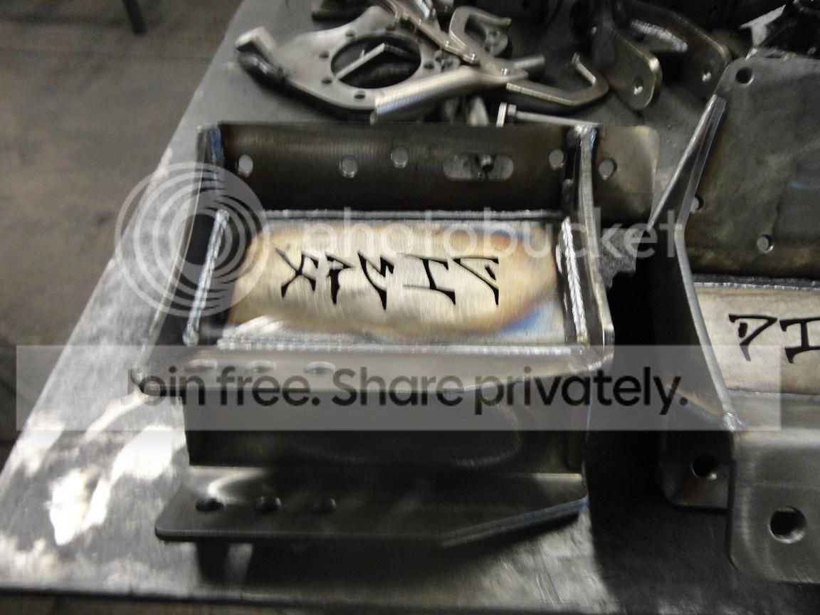

We have done a 1 ton. No reason we couldn't do it again. Need to double check a few mesurements but nothing challenging.
I'm not sure what i'm looking at in that picture.:dunno:
What about rearward adjustment (moving 52" or 56" springs back for wheelbase or axle position)?
Sure, why not! I'll try to post up another pic of an adjustable one we did that was set at the 1 ton spacing but center could go either way.
