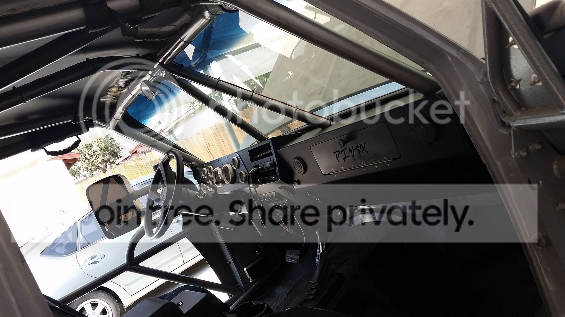

The inside of my K5 is bed lined with raptor but damn it gets hot in there driving down road. Curious about carpet vs rubber mat's the sell.
I hate carpet cause it gets dirty and stained.
Problem with either is I do not have side panels in rear as mine were trashed. Also don't have trim piece for under back seat.
So can i get options etc to maybe help cool down truck.

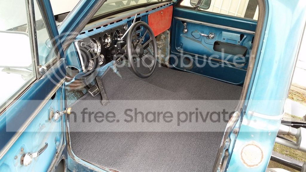

I have a pickup bed rubber mat in the back. In the front I have another rubber mat that I cut up to cover the whole floor up front. Not pretty, but works. I also have a building entrance mat called "3M dirtstop" in my C10. Works great and is a lot more pliable.The 3M stuff is "softer" on the feet too. The bed mat has done wonders to quiet down and fight heat in the blazer
The bed mat covers everything and runs under the seats to the back curb
Can I get a better few on last pic K85?
Also love the 68. My wife has 67 in my garage in pieces.

Raptor liner with a rubber floor from ACC. The front section has a nice heavy jute padding under it too. Came with the kit from ACC. I cut down a bed mat for the back. The heat last summer wasn't felt through the floor that was for sure. I thought I could run on the raptor liner alone, but I found when I was outfitting the interior the liner could get screwed up if you got to heavy with it. Larry had put a pretty big seed in my brain that the floor was going to get hot in the summer. I could see that with the raptor liner alone so I sprung for the ACC mat.
