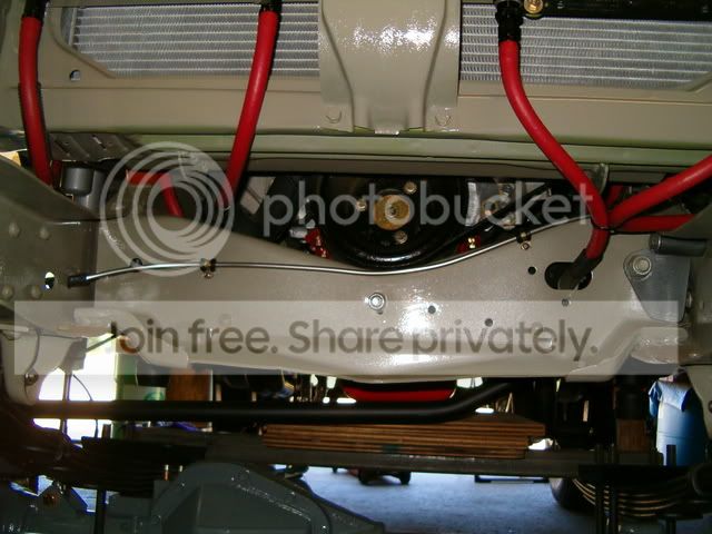

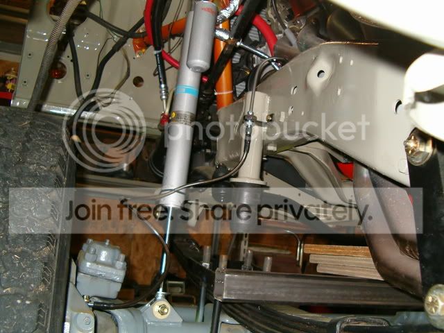

hmmm, this is how I did mine:
Seems like boxing those mounts would make them difficult to bolt on?
hey zim, off topic question. what color are you painting your frame parts? I'm looking for something lighter (so I can tell when there is oil or dirt on it), but not something obnoxious. I like that color in your pic.
wow that is clean! how did you run your brake hardlines? im just cuting around them and making access holes
The color of the frame is a single stage Nason Urethane...a custom color mix I picked off a chart, somewhere between Olive drab, and desert tan.
I made custom lines out of stainless, but it has a tendency to leak at the flares, was a real pain to get them to stop leaking..
wow that is pretty! ya im not a fan if flaring lines. i never had one not leak. idk if it was the tool i rented from autozone or what.
stainless makes it 100x harder.. I wouldn't do ss without my Mastercool tool...
