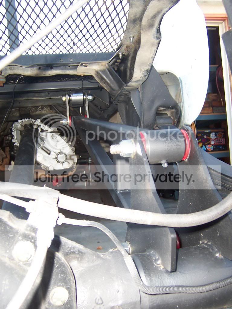

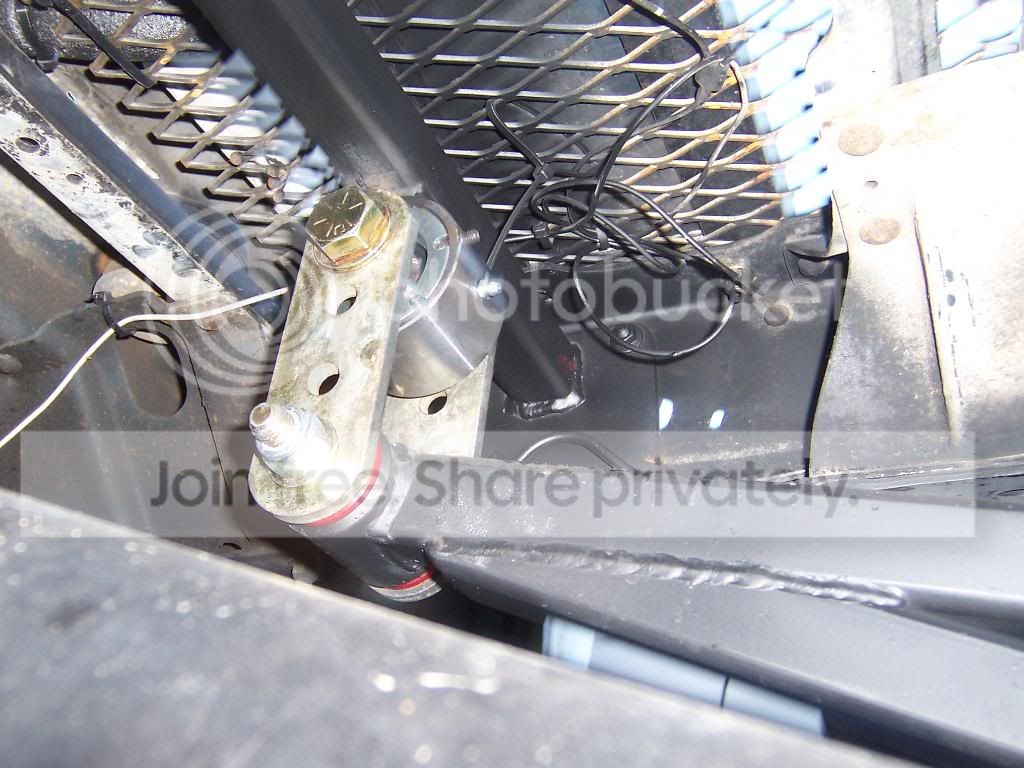

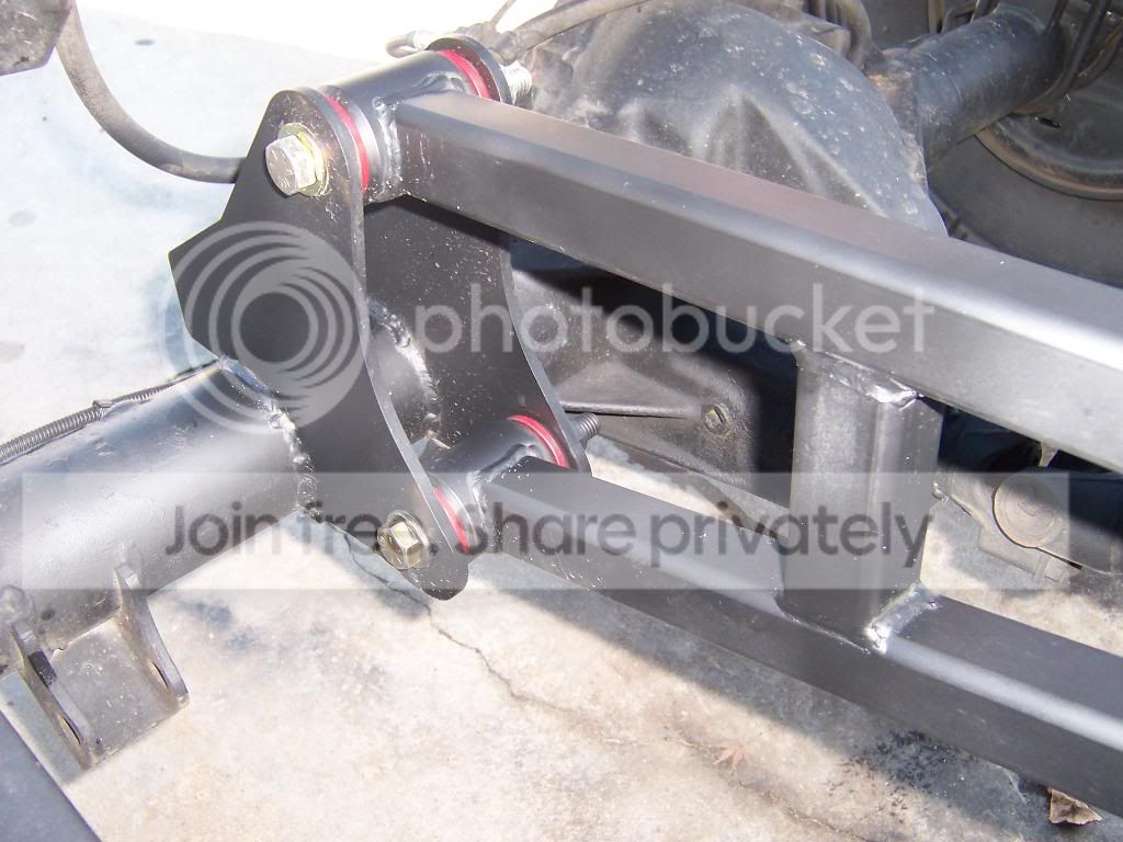

I used Poly Bushings in DOM sleeves at the axle end and a 3.0" Ballistic Joint on the crossmember up top and it's worked out really well. No more axle wrap/hop and it hasn't limited my articulation.
EDIT: Here's some pics
