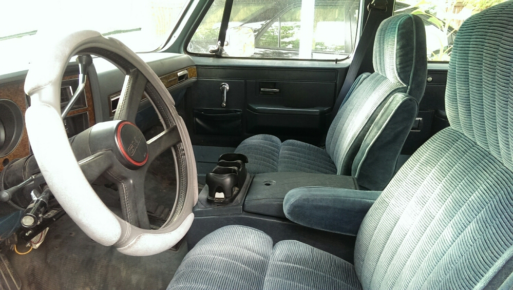

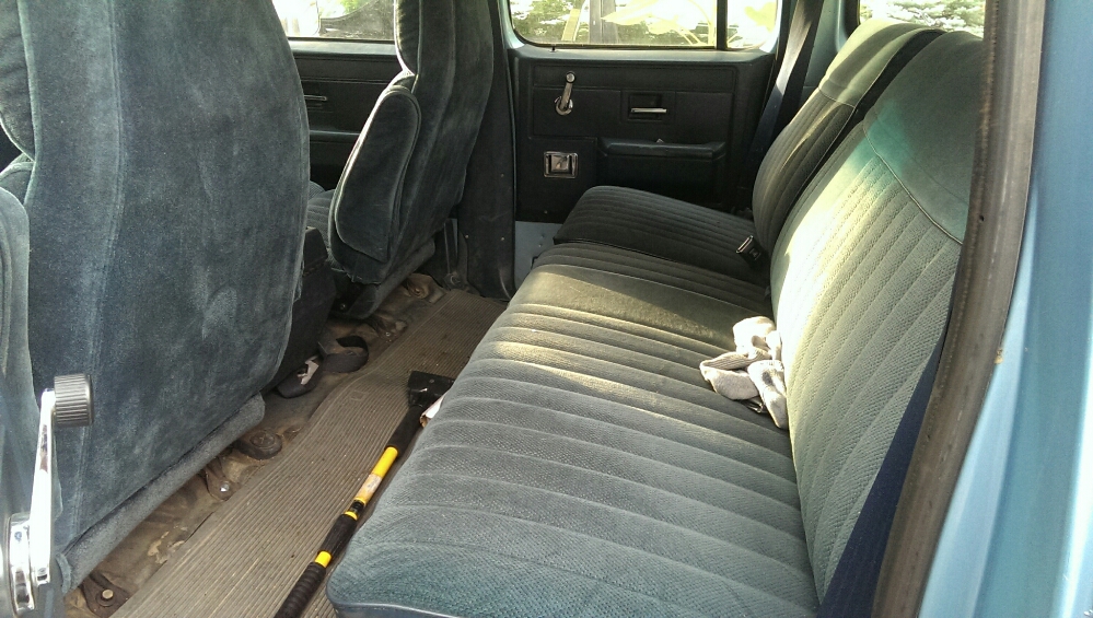

I just got a few pics:
Interior looks decent
More interior, again, fine

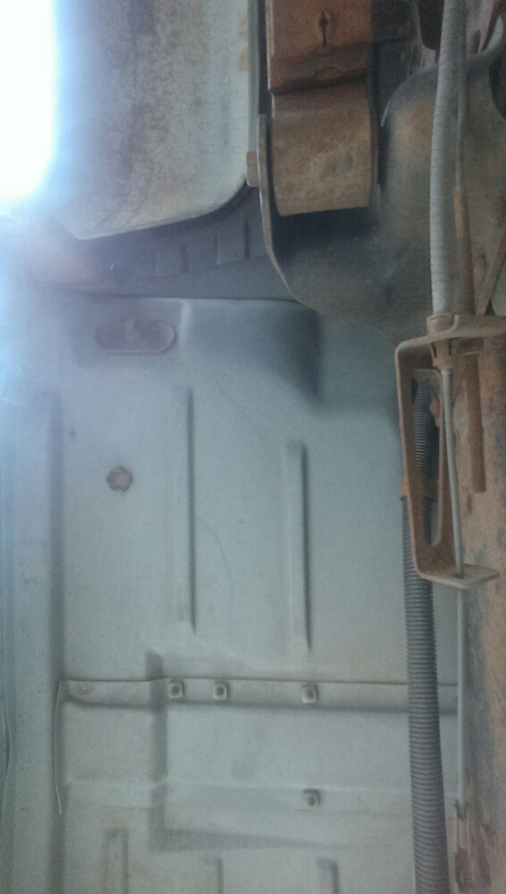

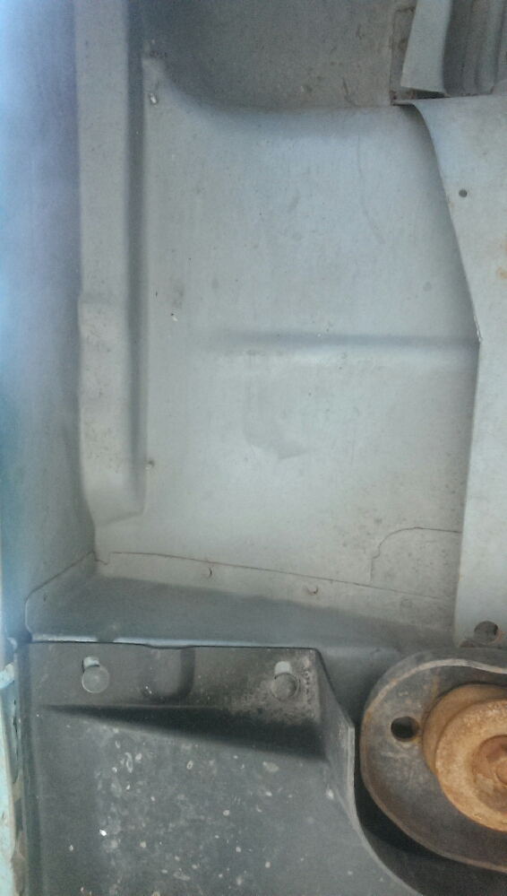

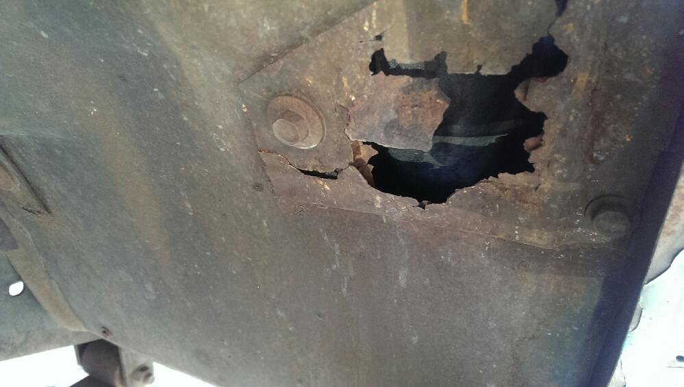

Looks like the rear portion of the front driver's side wheel well. This shouldn't be much of a problem, right?

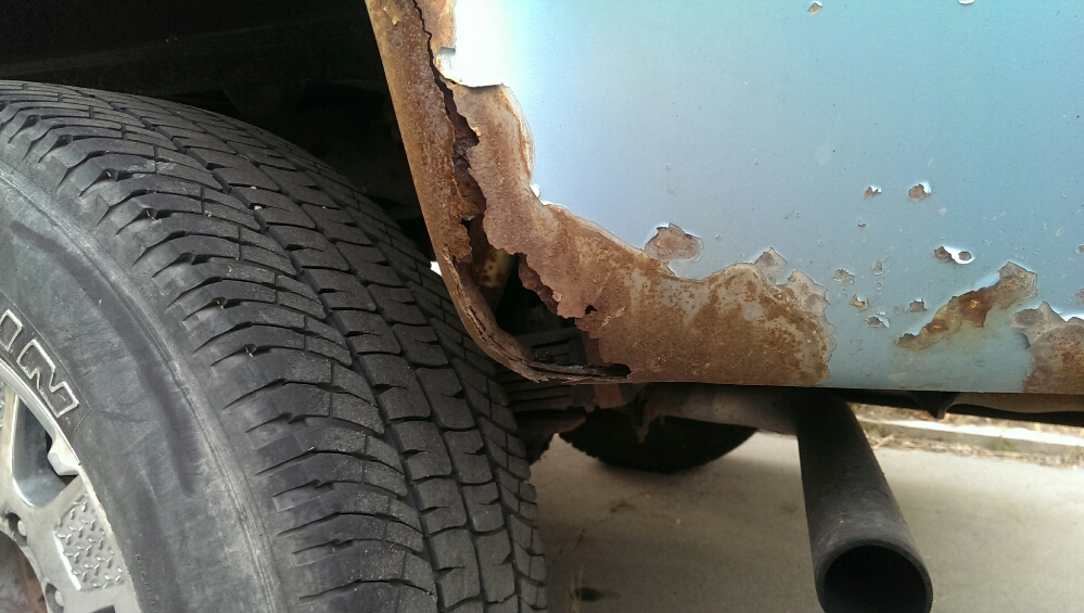

Fender, but I'm planning on trimming
Looks solid here
Also looks trouble free here.
They are some random shots he took for me. Would I be over-paying at $2,000 given rot, rough paint etc.? He's put about 20k miles on it over the last 2-3 years, so it surely isn't a basket case or anything. about 150,000 total miles right now. Engine hasn't ever been rebuilt. Thoughts?
Being that you are in ca, the rust is a big issue that helps bring the price down. But, being a diesel brings the price up for lack of smog. $2000 sounds like a good price for the area and a good deal for you since you were going to cut it up anyway.
thats some pretty minor rust, i'd buy it. i love that the 6.2L gets such awesome mileage, even if it isn't a powerhouse. the 4L80E is a solid trans too. like i said, i'd buy it. keep it low, stuff some tire in there and have fun! the longer wheelbase is more capable that you'd expect.
