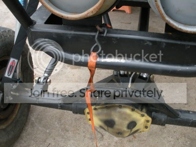

does anyone have pics of a rear susupention suck down winch step up on theese trucks??imm ahave to do something...granted i still have to add some oil and N2 to my shocks..they unload easy :eek1:
i couldnt even get the front on jack stands the other day to get the 44 out cause the rear kept unloading..here was my temporary fix and this strap is very,very tight
I haven't found that a rear suck down winch is needed for recreational wheeling.
I would do some shock tuning before jumping into the middle of that project.
If you really need one, just weld a 5/8" or so diameter solid bar bent in a loop onto the axle someplace that you can get into some beef. Then attach an atv type winch between your propane tanks with the cable running down to it.
Brandon pretty much said it.
I've never felt the need for a suck down winch, I don't really know what's going on with your setup unless the air shocks aren't adjusted right.
