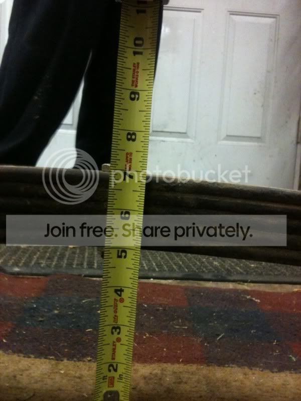

That is exactly what its from. I just ordered a set and dont want this mistake. Thats some horrible shackle angle. I have another question but dont want to start a new thread. Any idea how much lift these front springs yeild?
Adam are there any numbers on the spring ??
I'm gonna guess there 6" but the could be sagged 8"
No I dont think so 4" springs have a small arch to them and once they sag they get close to flat.

I bought a twin stick 205 from him awhile back, I dunno I think there at least 6"

I have some 4" springs on the front of that truck thats in my garage if you had a chance to look at those
Naw. I didn't look. But I thought factory at ride height was 2" negative arch. So if these sag 3" they're 6" leafs. Seems like it's be okay. More room for tires. Ordered my DIY4X shackle flip and 6" shackles and have a little 2" block if the ass end is a little low. But I'm going to run the 52"s off that truck I got from you. So they have a few more leafs and are definitely less sagged then the ones on the blazer right now. What size tire could I run with minor trimming and a 6" lift? I see DocWatson is running 42"s.... But I'm thinking 36"s and leaving the front D44 open.
