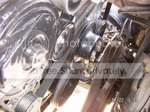

Look, I finally got this done:
The pump swaps over, but you need the serpentine reservoir. I found that my Goodwrench engine had 4 accessory-mount holes in the DS head, but only 1 in the PS head. So I drilled another one and tapped it. I went in about 5/8" deep and didn't hit the water jacket. I don't know how deep is possible.

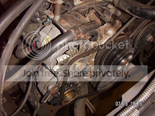

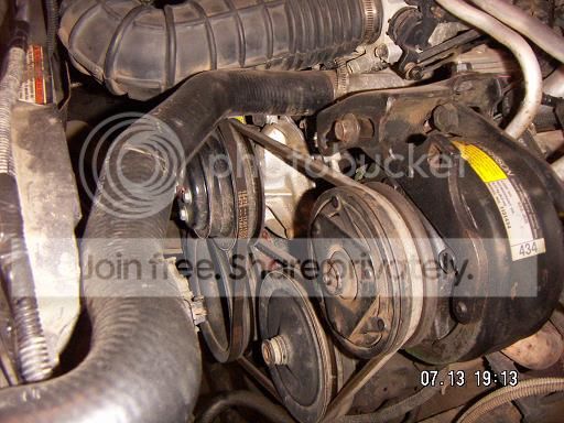

Confession..
After working on the truck today, due to a non start issue, I got a good look, and let it sink in, I guess, but anyways, I could have SWORN, that every belt but the ac was a flat/ribbed belt on the '87 model 350 TBI engines. I was wrong, it is only the alternator belt that is the ribbed one, the rest are still v-belts.
So I guess unless there is another model/year out there that uses the flat belts on all accessories, the other option to keep seperate belts for each item would be to do the March pulley conversion, as someone else I believe already brought up.
Ah well... :doah:
