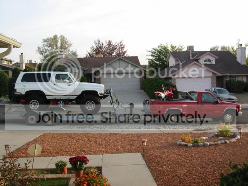

you know those straps that are everywhere on the boat, and the base, the white ratchet straps?
I have aquired 6 of those and used those on the blazer 4 on the axles, and 4 on the bumpers, 2 front and 2 back in a "X" the blazer diddent move at al, and even with the craptastic roads on the way back, the straps diddent move at all and everything was cool
those straps are rated to 5K LBS
you can kinda see it here
