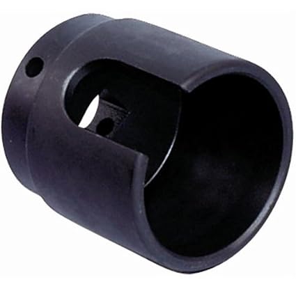

What have you had success with for pulling the TRE off of the tie rod or DLE off the drag link? I'm not talking about a puller or pickle fork to get the stud out of the steering arm, pitman arm, etc. I'm taking about threading it out after it's separated. They make a large socket with a slot in it for the stud to pass through. Will these mess up the stud if you hammer it with an impact?

I've used those tools before. Never had luck freeing a really stuck end with them. They were good for getting ends off quickly, but that's about it.

Those tools pictured for tie rods do work,but on an air impact they are scary...once the tie rod comes free ,it can spin it out at high speed,and the tie rod can be flung out of the tool like a missile..:eek1:..they do put a lot of side loads on the ball socket too,I've seen the ball stud get ripped out of old tie rods before,and go flying when used with an air gun..
Yeah, maybe It's too hard on the TRE with the impact cranked up. I thought the impact hammering would help break it free. These ORD TREs have nothing to put a wrench on and now the body is chewed up with pipe wrench marks. This drag link is thick-walled tubing with the threads tapped onto the inside. I agree that the sleeve style is easier to break free.
