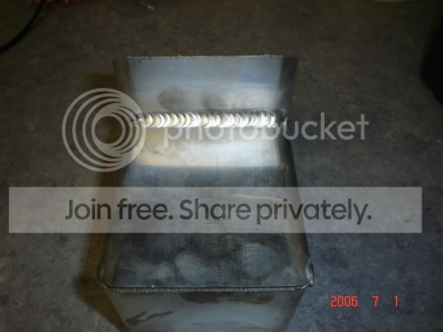

i've never worked anywhere where TIG anything was used much until the job i have now. We don't do a ton of it, but moreso than anywhere else I've ever worked. Been practising a bit here and there and did this one today. It's .250" wall 4" x 4" tube...
I have a good sized frame made of this stuff I'm welding up and this piece was something I did to get the heat set and get comfortable. I was pretty happy with it, but still have a long way to go as far as learning and practise go.
Thought I'd share. 1/4" thick aluminum is tough when it's good size...on the frame itself i need to pre-heat each joint to about 250F.

You made a nice pretty weld.. good job on the preheat.. sounds perfect...
Im assuming you welded from left to right in the pic.. and the stacking or dimes got smaller as the heat to the work increased... try to practice consistency all the way across... so they look the same start to finish.. perhaps linger a second longer at the start.. I can be super critical because it already appears you are an excellent welder... as I expect you to be with my welding
On bad days I actually count to myself to force myself to move consistently... count move dab move.. and I really try for a nice steady straight pull thru the whole weld.. I practice first during setup all the way across the weld so I know how and where my hand will move along the weld.. I must be comfortable to produce super nice looking welds.. I notice my weld appearance quality goes down if Im in an uncomfortable position... and my breathing isnt easy and regular
That machine is pulsed if I recall... try that when you get the hang of it and see if you like pulsed better.. (I dont but many people swear by it and it makes very consistent beads)

I'm still a total n00b when it comes to TIG, this was a bit of a breakthrough for me today. Finally seemed to get the hang of the motions and the heat etc etc. I agree that being comfortable is crucial to any welding...but seems doubly important with TIG.
The weld did get slightly larger as I went, but the pieces of crop i was welding were pretty small and were very rapidly getting over heated. Looking at it i should have backed off the pedal a bit but I imagine that sort of reaction will become more second nature the more I do this.

Are you using a gold plated lense? A friend turned me onto those for welding aluminum. Aside from the higher heat rejection they make it easy to see the color change in the metal.
I've also found that DC Reverse with a 2% on thick (1/4"+) and really thin works better than AC. Could be that with these new inverter machines you don't need to do that, I've not tried one yet.
I'll try the gold lens Thom. I have used them in the past and even welding steel I really like them.
