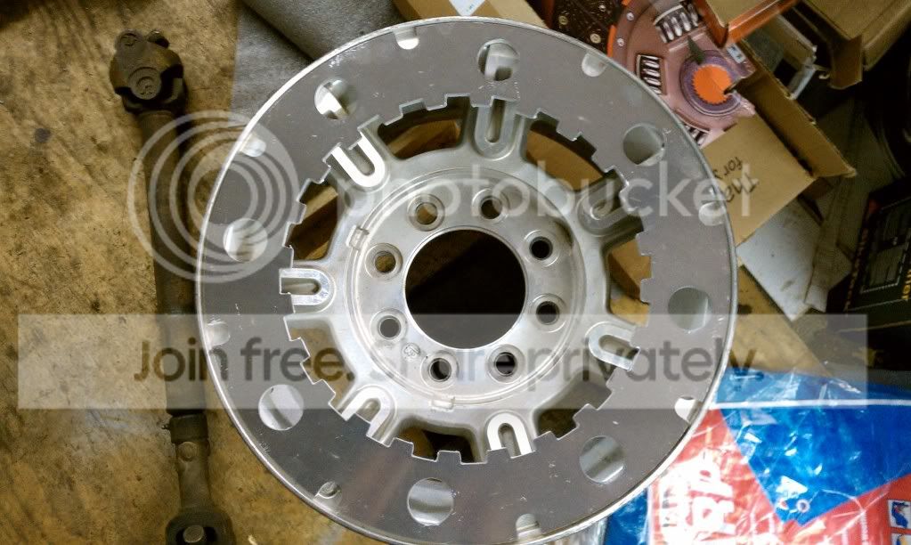

I have a set of H2's that I need rock rings welded on and I received my first quote of $100-150 per wheel ($400-$600 total). I don't know or pretend to know how to tig weld but that sounds like an ass raping. I want to be fair but for $600 I'll be putting that money toward a TIG setup before paying for his.
Here are the rims, damn near perfect shape (off a limo)

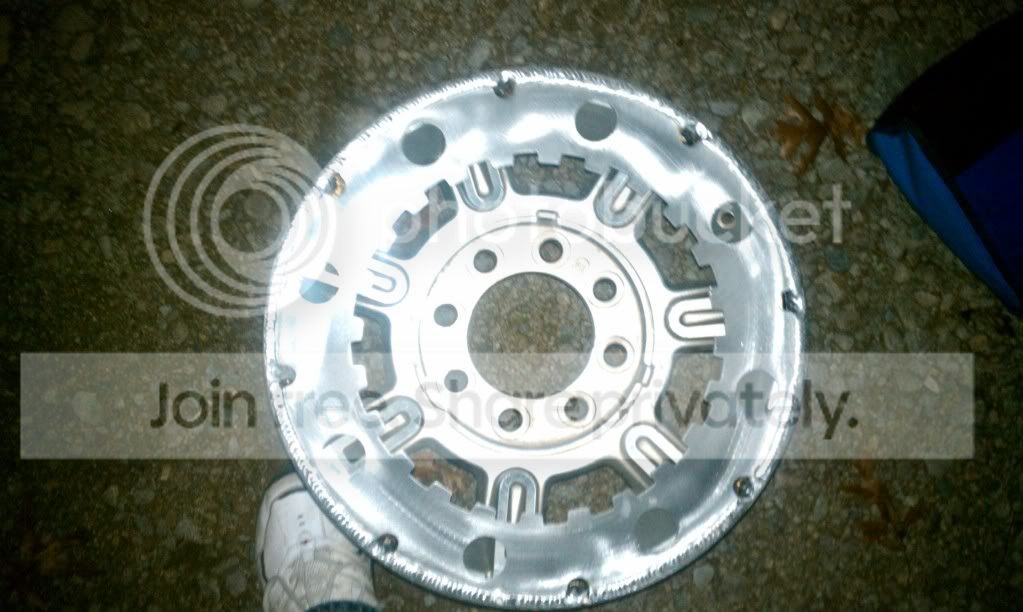

These aren't my photos below but the same rock rings (Air-innerlock) that I'm using
and welded

That last picture doesn't look like a tig weld to me. Looks like a spool gun run on a mig welder. You can do a very nice job welding aluminum with one. Ive done it a good bit.
Very well could have been a spool setup.
