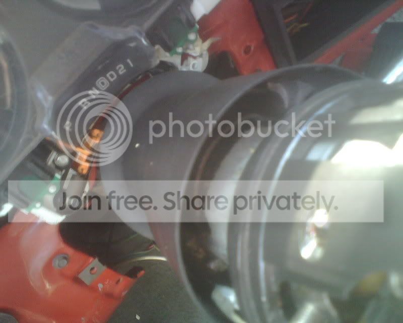

Front view:

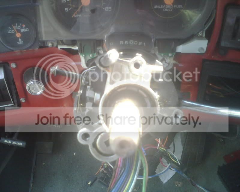

Where the gearshift sits in place

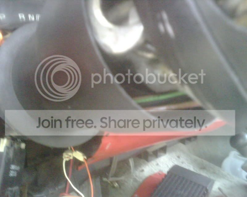

Underside

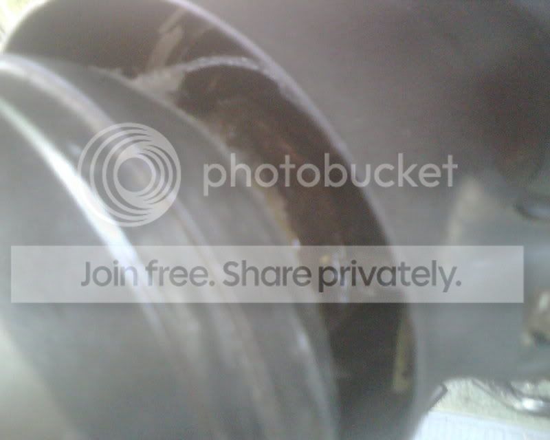

Top view - this is the bit I'm wondering about. It seems it should notch in there somehow. There's a piece on the upper part of the column that looks like it should slide into a notch on the inner ring where the threads are drilled for the tilt crap to bolt into, maybe 3/4" wide and 1/2" long, but it will not go down no matter what I do.

Front view:
Underside
