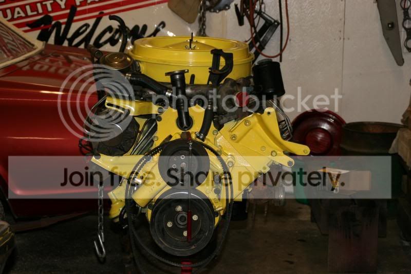

the oil pump just slides in like you said. :) i had a heck of a time with leaks after i first rebuilt my engine. i pulled it out on friday to deal with all the leaks and went crazy with RTV and new gaskets! :D and a couple cans of engine enamel!
it's going back in tomorrow:
it's important that you got some good rtv in where the timing cover, engine block and oil pan all come together. also, when i did my front main, i put RTV all around the outside of it before i put it in the cover. mine leaked real bad from there before, so this should take care of it. :) i also went after the rear main cap w/ sealant and rtv, as well as rtv on both sides of all the gaskets i installed. :haha: should be good to go for a few hundred years and a few million miles! :D
